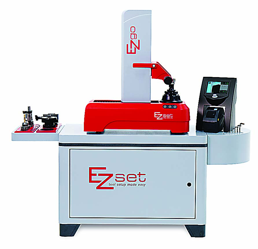

Ian Haase, North American product manager for EZset LLC, Ann Arbor, Mich., said presetters enable shops to just check tool runout, do quick measurements of lengths and diameters and then print tool-offset information on a label or bar code.
“We offer presetters with tool management capability, pneumatic spindle functions, vacuum or power clamping, autofocus, machine tool integration and so on, but for shops that only need basic functionality for use on the production floor, those machines are available as well,” Haase said. “The important thing is to start presetting. You’re losing money otherwise.”

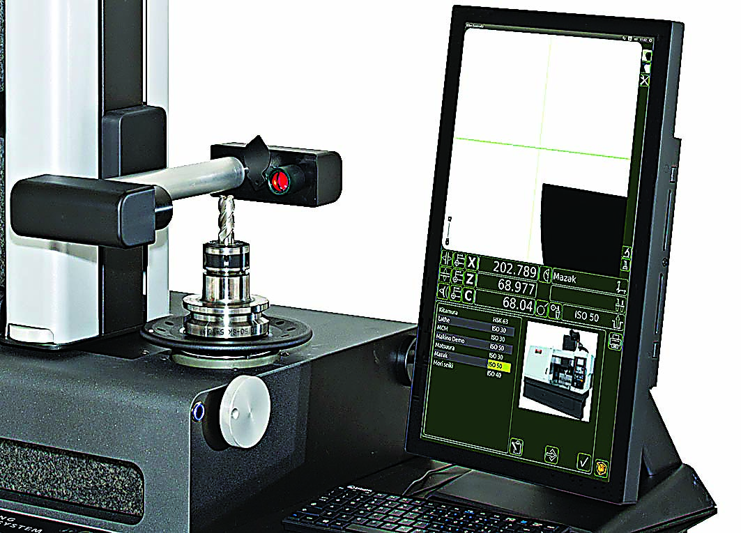

Most presetters use high-resolution vision systems to find tool edges. Image courtesy of Koma Precision.

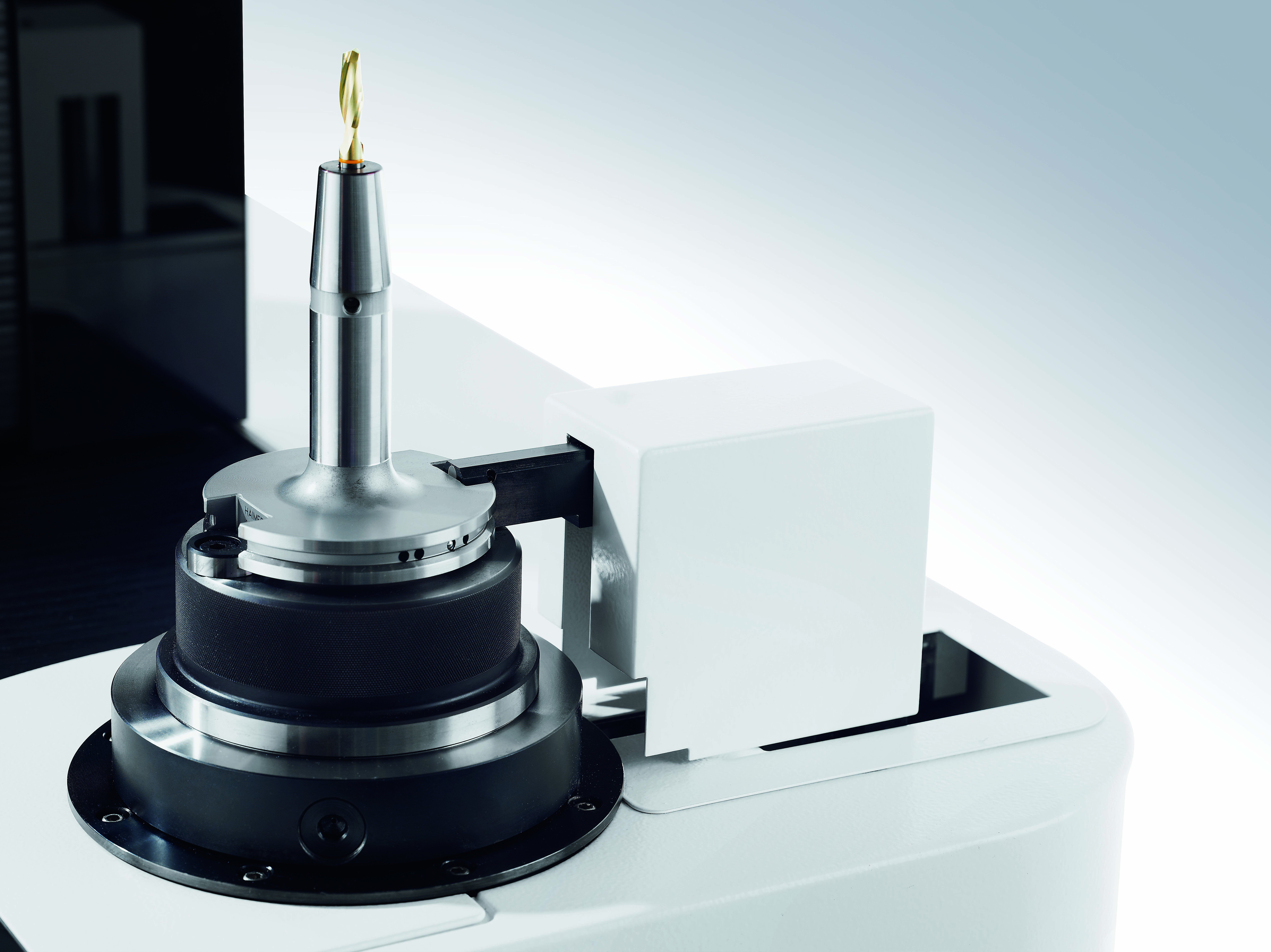

Chief among those uses is visual inspection of cutting tools, something that many shops don’t give much thought to. “They order a ½” drill from a large tooling supplier and assume that it was manufactured correctly,” Colyer said. “Maybe it was, maybe it wasn’t, but you can’t eliminate that variable without inspecting it first. This is one function that any presetter is perfect for, even if it doesn’t have some of the higher-end capabilities.”

Though they offer limited functionality, entry-level machines are a great way to get started with presetting. Image courtesy of EZset.

Italy’s Elbo Controlli offers another presetting solution. David Meo, sales manager for East Windsor, Conn.-based Elbo Controlli distributor Koma Precision Inc., said it’s important to look for a presetter mechanically suited to the rigors of the shop environment and with software capabilities appropriate to a shop’s needs.
“You need thermal stability to assure accuracy, as well as the tools to make the entire process more efficient,” Meo said. “A high-end presetter is going to have wireless capability, so you can send information anywhere on the network. It’s also going to let you import or export CAD files, such as DXF tool drawings. That allows you to make an overlay to check the actual tool for conformity to its intended design. Without this capability, you’re relying entirely on the cutting tool manufacturer, which could be an expensive mistake.”
Meo agreed that accuracy is another important feature, with 2µm or better being the norm for high-end presetters and 2µm to 4µm for entry-level models.
When asked about static vs. dynamic accuracy and the fact that tools deflect while in the cut, thus negating any benefits of greater accuracy, he said that’s easily compensated for. “You preset the tool, put it in the machine and cut the first piece. At any point after that, you can remeasure the tool and update the software with the actual post-machining offset values. This allows you to constantly measure and update the system—in essence making it smarter as you go.”
