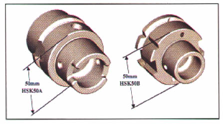

Figure 2: On the left is a typical HSK50A shank with a 50mm-dia. flange. The HSK50B shank on the right, which also has a 50mm-dia. flange, has a shank one size smaller.
(Click for larger image)
The principal difference between shank styles A and B is the size of the taper. The B-style shank will have a taper one size smaller than an A-style shank with a flange of the same size (Figure 2). For example, an HSK50B shank will have the same 50mm-dia. flange that an HSK50A shank has, but its taper will be equal to an HSK40A taper. This is true of the D and F shanks as well; all three will have tapers one size smaller than A, C, and E shanks with the same flange diameter. The smaller taper leaves more room on the flange’s face to mate with the face of the receiver. The bigger flange area allows manufacturers to locate drive slots on the flange and combine drive slots with gripper-locating slots to transfer high torque. The bigger flange also makes it possible to supply coolant through the face if it is necessary to reroute coolant to protect the internal clamping mechanism from corrosion. Shank style C was designed exclusively for manual use. It is a copy of shank style A, with the elimination of features that style A has to accommodate automatic toolchangers. Style D differs from style B in the same way.
To handle extremely high rpm and the machining of light materials, shank styles E and F were designed to be totally symmetrical. Their symmetry minimizes unbalance, which can be a significant problem at high speeds. Torque is transferred from the spindle to the toolholder only through friction between the tapers and faces of the mating shanks and receivers.

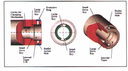

Figure 3: The basic features of an HSK spindle receiver are shown in this series of cutaway views.
Figure 3 presents cutaway views of typical A- and C-style receivers. The receiver design includes an internal taper with a 1-to-10 ratio and milled drive keys with heights that match the unequal depths of the shanks’ drive slots. The partial profile of the drive keys also is cylindrical. The internal space of the receiver is designed to house the clamping mechanism, which is not yet standardized. If a manual clamping unit is incorporated, the receiver’s radial access hole can be used for clamping or releasing tooling shanks. When the access hole is to be used, a protective ring covers it to keep out coolant and chips. An internal coolant supply can be included as part of the clamping unit.
Receivers for B and D shanks are slightly different from the A- and C-style receivers. B – and D -style receivers feature external drive keys similar to the design of traditional steep-taper spindles. In these receivers the coolant supply can be routed through the flange, bypassing the clamping unit. Some people in the industry believe that A – and C – style shanks are interchangeable with B – and D -style shanks. This is not true. The HSK developers were going to make these shanks interchangeable, but they abandoned this idea in the final version of the standard.
Receivers for E – and F -style shanks, like the shanks themselves, are totally symmetrical. Because the receivers do not have any drive keys, torque must be transferred entirely by friction.

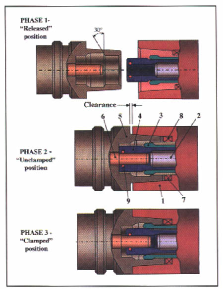

Figure 4: In the first phase of the HSK clamping action (top), the mechanism is in the released position and the shank is out of the receiver. In the second phase (middle), the shank has been inserted, but the mechanism has not yet been actuated. In the final phase (bottom), the drawbar has pulled the sleeve in, pushing the collet segments out to engage with the chamfer on the shank’s inner diameter.
An HSK connection depends on a combination of axial clamping forces and taper-shank interference. All these forces are generated and controlled by the mating components’ design parameters. The shank and receiver both must have precisely mating tapers and faces that are square to the taper’s axis. There are several HSK clamping methods on the market. All use some mechanism to amplify the clamping action of equally spaced collet segments. The steps illustrated in Figure 4 show how a typical clamping mechanism is actuated.
In the first phase of the clamping process, the mechanism is in the unclamped position. The drawbar (2), which is located in the spindle (1) and is rigidly connected to the sleeve (4), is released. This allows the collet segments (3) to contract inside the sleeve’s cavities. With the segments in this position, the operator can insert the shank into the receiver, engaging the drive keys (7) and (8) of the spindle with the mating slots on the shank.
In the second phase of the clamping process, the shank is in the receiver, but the clamping mechanism is not yet actuated. Because the gage diameter of the shank is slightly larger than the gage diameter of the receiver, the toolholder does not slide fully into position. As a result, there is some clearance between the flange and the face of the receiver.
In the third phase, the mechanism is actuated. At this point, the drawbar pulls the sleeve in, away from the toolholder. As a result, the collet segments expand radially, and their 30O chamfer engages the mating chamfer on the shank. This amplifies the force of the drawbar. This force is transformed into pullback forces that are equally spaced and applied to the circumference of the 30O chamfer inside the shank.
As the collet segments engage, the pullback force causes the shank to deform slightly, pulling the shank further into the receiver until contact is made between the flange and the receiver’s face. The fact that the two tapers are in intimate contact due to the elastic deformation of the shank ensures the positioning accuracy and repeatability of the joint, both radially and axially, to 0.0001″. At the end of the clamping cycle, the sleeve engages the coolant nozzle (6). The drive keys (7) and (8) transfer torque.
When the toolholder is clamped into the receiver, the drawbar force at first produces a firm metal-to-metal contact between the tapered shank and the inner diameter of the clamping unit. An additional application of drawbar force positively locks the two elements together into a joint with great radial and axial rigidity. During the clamping process, some of the clamping unit’s energy will be spent compressing the shank taper to pull the shank deeper into the receiver. Depending on the amount of clearance, up to 20% of the axial clamping force may be needed to pull the toolholder in. The larger the clearance between the mating faces, the more energy will be needed to bring them together.
Take the connection of an HSK40A toolholder as an example. If the clearance distance is 0.005″, the clamping unit will have to exert about 1200 lb. of force to achieve initial face-to-face contact. If the clamping unit is capable of generating a total of 5200 lb. of axial force, it will be able to exert 4000 lb. on the face of the connection after bringing the holder and the receiver together. But if the unit can generate only 2500 lb. of axial force, it will be able to exert only 1300 lb. of force on the connection after using 1200 lb. to close the gap between the flange and the face.
To avoid wide gaps that waste clamping-mechanism energy, the HSK standard dictates tight tolerances for taper gage-line diameters. Such accuracy is needed because each 0.001″ deviation in the gage-line diameter will result in a 0.001″ error on the face clearance when the taper ratio is 1-to-10.
