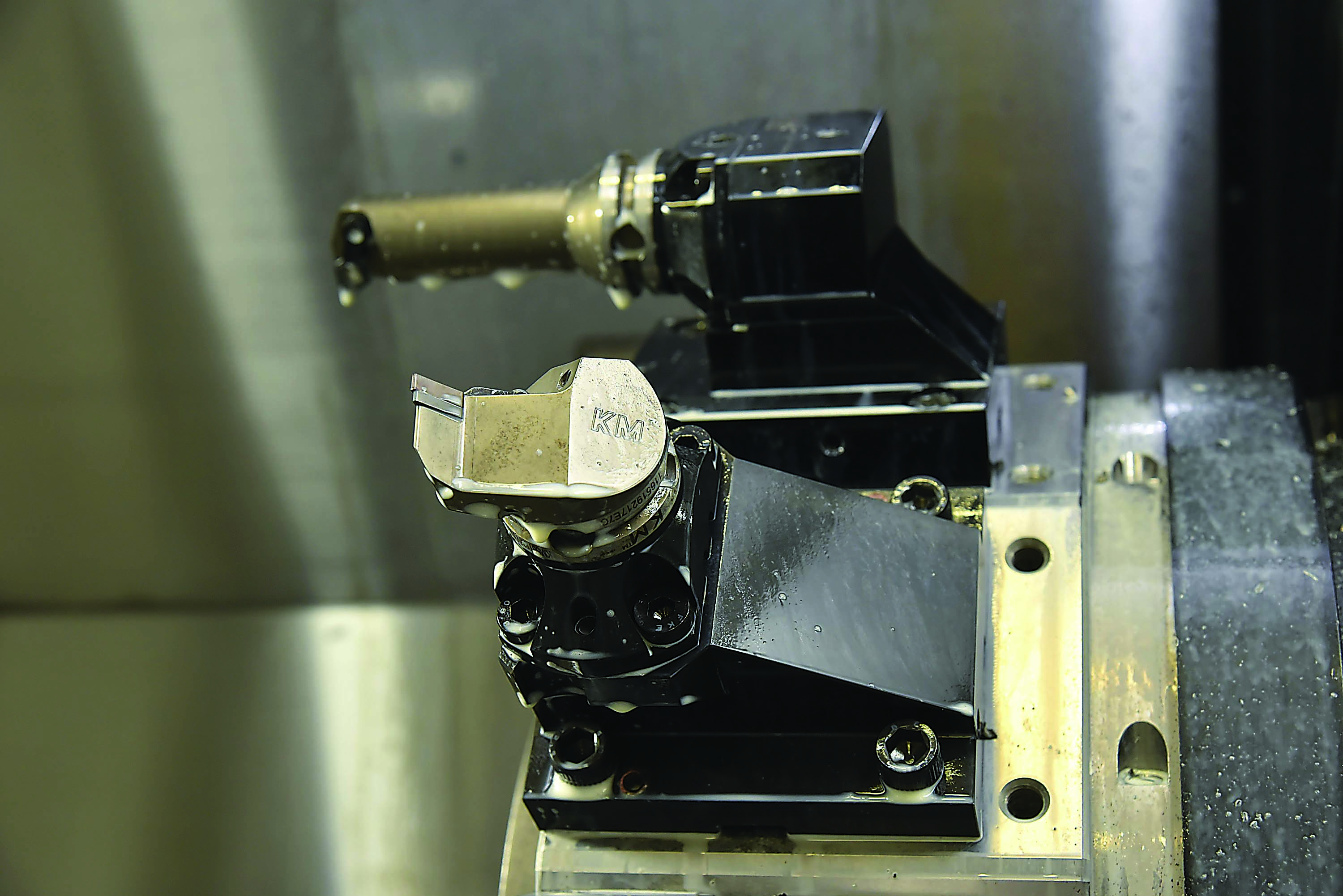

After seeing the benefits of using KM on Anthony Machine’s new NLX machines, the company plans to expand its use of quick-change tooling to other areas of the shop. Photo credit: Kennametal
After seeing the benefits of using KM on Anthony Machine’s new NLX machines, the company plans to expand its use of quick-change tooling to other areas of the shop. Image courtesy of Kennametal
“Compared to the traditional wedge and screw-style blocks that come standard on most machines, the KM-equipped TACUs are both faster and more accurate,” he said. “We routinely hold tolerances of 0.0005", and I’m told that part size doesn’t change from one clamping to the next. The turret is less crowded, everything is easier to get at, and you don’t have the chatter and deflection that you often find with your typical straight-shank tools and setscrew-type boring bar holders.”
Goller added that the traditional block connection was cumbersome because it required a machinist to hold several different parts, mount the part and make sure everything was straight. The KM toolholders, on the other hand, have a taper and face connection that mounts with a couple of turns of a torque wrench.
“The KM connections just repeat and are always straight,” Goller said. “You don’t have to fight to make sure your tools are right. There is only one way to put them in. There is no misalignment like there might be with conventional tooling.”
For example, if a boring bar is not aligned properly, it affects cutting geometry, which means that a machinist is more likely to have issues with chatter, Goller said.
“On the other machines, we are happy if we hit a 32 µin. Ra finish, which is not much to write home about,” he said. “On the new machines, we easily hit 10 to 11 µin. Ra.”
With the KM-equipped TACU system in place, Goller said Anthony Machine reduced tool setup time by about 50%.
