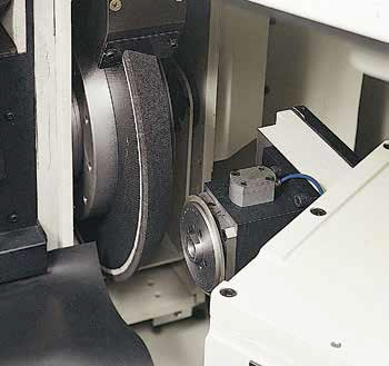

Okuma%20HS%20grinding%20Rotary%20Dresser.tif
Courtesy of Okuma
A vitrified CBN grinding wheel with a rotary dresser. Okuma offers an HSG spindle (120 m/sec.) on its GP-25TII grinding machine.
He added that a chiller unit is added to the spindles because of the increased heat. "On the grinders we build, we try to control that high-speed spindle's oil. We keep the temperature constant so there are no tolerance control issues."
