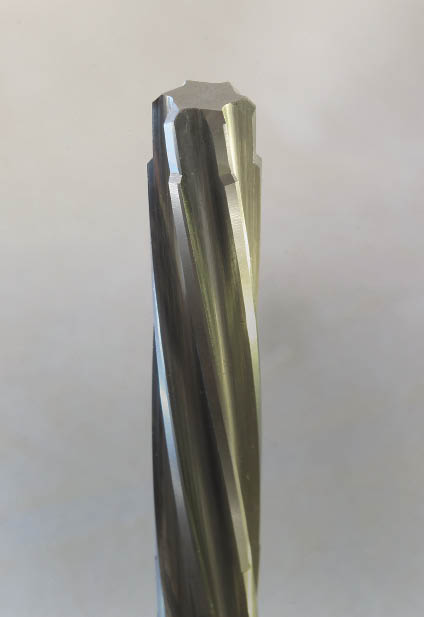

A straight-flute reamer (left) can cut titanium, but helical reamers can provide freer cutting action and can direct chip flow. The cutting angle of the flutes of a left-hand helix reamer (right) is not as positive or acute as a right-hand helix reamer (center), and therefore does not cut as freely. However, the left-hand helix tool forces chips forward and out of a through-hole. In a blind-hole, the flutes of the right-hand helix tool lifts chips up and out of the hole.

Bill Lahr, tooling engineer at Alvord-Polk Inc., Millersburg, Pa., said titanium generally doesn’t require special reamer geometries, and “if it is a HSS tool, we use a M-42 cobalt grade because of its resistance to heat, higher red hardness, if you will.” According to titanium supplier Timet, while in many cases HSS reamers are satisfactory, carbide reamers allow higher surface speeds or longer tool life.
As for flute geometry, Forrest said helical reamers are preferred over straight-flute reamers, “because the action of the helix is going to give you a little freer cutting condition. Plus, if it’s a through-hole, a left-hand helix will drive the chips and heat forward. The downside is that the left-hand helix doesn’t provide a real positive angle at the chamfer and therefore is not as free cutting. In a blind-hole, a right-hand helix will provide a freer cutting condition, as well as lift the chips up and hopefully out. It gives you a more acute angle at the cutting edge, making it freer cutting.” In addition, the angled path of a helical reamer flute can help minimize the impact of cross-holes and other interruptions in the bore being reamed.
Hurd of Port Huron, Mich.-based Mapal noted that a reamer features circular lands or guide margins that direct the cutting edge through the bore, but because they rub on the side of the hole they can create additional heat. For titanium, he said the guide margins would be narrower than they would be when machining steel or cast iron.
