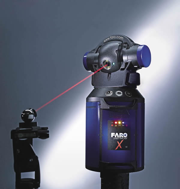

A Laser Tracker from Faro Technologies can measure a component, such as a propulsion drive shaft, anywhere and in any orientation.
A Laser Tracker can inspect a shaft anywhere and in any orientation, eliminating the need to remove the shaft from the lathe and position the gage using a crane, according to Chuck Pfeffer, director of product development for Faro, who's based in Kennett Square, Pa. He explained that to scan the taper section, which measures about 4 ' long by 2 ' in diameter, an operator first scans half of it from one vantage point by sliding a laser-following probe along the surface of the shaft taper, recording the data as the probe moves, scanning the other side and then tying the two coordinate systems together to provide a single set of scan data. Software, available from multiple developers, allows a user to collect thousands of data points and compare them to a CAD model of the shaft or gage. The software also generates a color map report and a statistical report.
"Pretty much in real time, you can see the data compared to the CAD model on the screen, and analysis tools tell you what percentage is within a certain tolerance to simulate the bluing," Pfeffer said. "We were trying to get as close a comparison to the gage as we could."
He added that laser measurement provided a numerical value for the amount of material that would have been interfering with the gage, as well as the gage's distance from low, worn areas on the shaft. "You didn't just get a shade of blue, you got a number."
Laser-based measurement also quickened the machining process. "They tended to take off very little material at a time when they were doing the gage process because they were not that confident in what they were doing based on the feedback from the gage," Pfeffer said. "With the Laser Tracker, you could take off more material at once, being confident that you knew how much to remove, reducing some of the iterations."

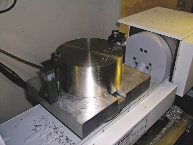

NCDMM performed "proof-of-concept" drilling tests on a 4"-thick Inconel sample to help Hamill Manufacturing reduce its machining time by 50 percent.
NCDMM conducted machining tests on a sample Inconel workpiece using a Haas vertical machining center and determined a special Star Cutter gundrill with application-specific point geometry produced the best results. According to NCDMM, gundrills are designed to produce deep, straight and accurate holes. "The deeper the hole is, the harder it is to keep the tool straight," said Dave Karpinski, Hamill's tooling coordinator.
In addition to having a high-quality tool, the best results occurred when the gundrill entered the pilot hole rotating counterclockwise and then changed to clockwise rotation when the actual drilling began. Because there's only a minimal amount of clearance as the gundrill enters the hole, that procedure prevents the tool from rubbing the workpiece, Karpinski explained.
Retracting the drill from the hole with the machine spindle turned off also proved beneficial. "If you're retracting the gundrill and the spindle is on, you'll turn that gundrill into a pretzel," Karpinski said.
