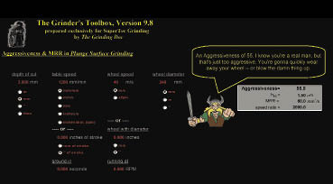

The Grinding Viking gives valuable—if sometimes impolite—advice about your grinding parameters.

So, during the past few years I’ve developed The Grinder’s Toolbox, a rough-and-ready spreadsheet for quickly calculating grinding, dressing, sticking and cooling parameters: material-removal rates, aggressiveness values, dresser speed ratios, dresser overlap ratios, OD grinding overlap ratios, continuous-dress dressing DOCs, coolant velocities and pressures, and pump and nozzle sizes. Then I get on the machine, enter the parameters and know immediately if they’re in the ballpark.
For example, a few months ago I got a call from a company having major burn problems on one of their machines. The owner was in a panic because parts were coming out “toasty.” We methodically covered the checklist of grinding, cooling and dressing parameters. One-by-one, I plugged them into the spreadsheet to see if they were reasonable. They were, except for the dressing parameters.
The company was using a rotary plunge roll to form dress. The roll was 3 " in diameter and running at 300 rpm. The 350mm wheel was running at 70 m/sec. unidirectionally, plunging into the roll at 0.02 ipm and then dwelling 3 seconds.
The operator looked at me and asked whether the parameters were good. Of course, my answer was “I dunnknow. That’s a lot of numbers and a lot of different units.”
Then I pulled out The Grinder’s Toolbox and punched in the parameters. Sixty seconds later I had the three meaningful values: speed ratio, plunge depth and the number of dwell revolutions.

The speed ratio was +0.17. That will make a wheel quite dull. The plunge depth was 0.13μm per wheel revolution, also dulling the wheel. And the wheel was dwelling 191 revolutions—far too many, further dulling the wheel.
It was obvious the company was dulling its wheel in three different ways, causing atrocious burn. We set about fixing this.
However, we had to deal with machine restraints. The roll speed was fixed, so we played with wheel speeds and plunge speeds until we found a combination that provided a sharp wheel and a slow enough feed rate not to cause chatter.
Why did we need my spreadsheet? If we changed the wheel speed to give us a ratio we liked, we would have inadvertently changed the plunge depth and number of dwell revolutions. Entering all the possibilities into a calculator would have taken all day.
But with The Grinder’s Toolbox we quickly punched in numbers and saw the results. We ended up dropping the wheel speed during dressing to 20 m/sec., providing a speed ratio of +0.6, which gives a sharp wheel. We then increased the plunge speed to 0.04 ipm, which gives a dressing depth of 0.93μm per wheel revolution. That also provides a sharp wheel. Finally, we dropped dwell time to 2.0 seconds, giving us 36 wheel revolutions. The result was a sharp wheel that immediately eliminated the burn issue.

The Grinding Viking
Remembering recommended ranges and ratios can be tough. In diamond-roll plunge dressing, a depth of 0.1μm per wheel revolution gives a dull wheel, but a depth of 1.0μm per revolution gives a sharp one. In single-point dressing, a dressing lead of 0.2 mm/wheel revolution gives a sharp wheel, but if you’re using a diamond cluster it’ll dull the wheel. In OD traverse grinding, an overlap ratio of 3 is effective for roughing, and a value of 8 is good for finishing.
Remembering all these values is tough. So I also developed The Grinding Viking. He tells if you are within the recommend ranges or making a mistake.
However, The Grinding Viking is not for the thin-skinned. He’s opinionated and sometimes a little rude. But he’s seldom wrong.
Calculations in The Grinder’s Toolbox for plunge surface grinding. The primary outputs are aggressiveness and material-removal rate.
