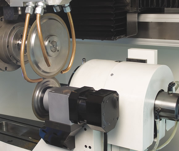

Dressing_%26_Opening.tif
Courtesy of United Grinding
A dressing operation on the Walter Helitronic Vision grinder.

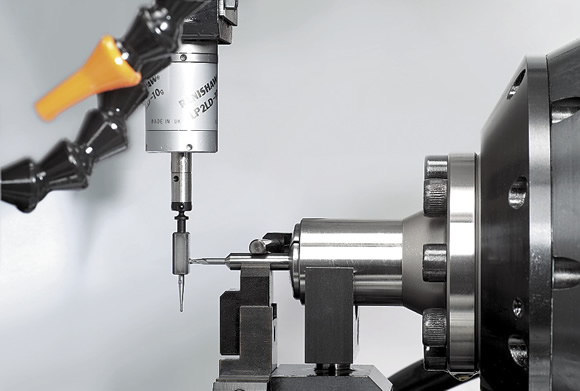

Probe%20operation.tif
A probe operation on a tool grinding machine. Some of the same techniques appropriate for controlling vibration when tool grinding apply to making microparts.

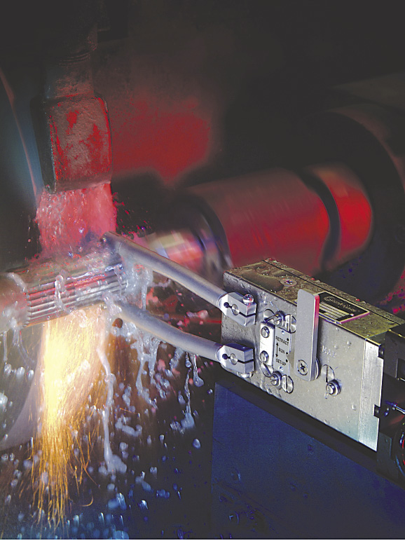

InProcess%20Measurement%20Instrumentation%20from%20Control%20Gaging.tif
Courtesy of Control Gaging
An in-process grinding measurement instrument from Control Gaging.

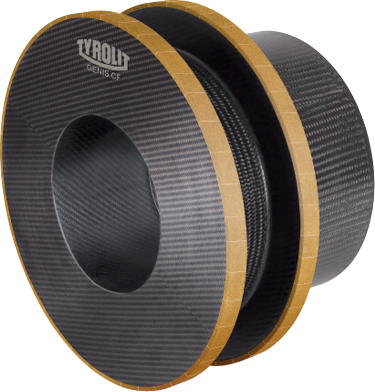

While attention is being given to processes that affect the grinding machine and wheel balance, developments regarding wheel structure are also ongoing. Radiac Abrasives Inc., Salem, Ill., offers the Genis vitrified CBN wheel from parent company Tyrolit, equipped with a carbon-fiber core, which exhibits significant vibration-damping characteristics compared to the traditional steel core, according to the company.
Genis%20Carbon%20Fiber%20Wheel%20by%20RadiacTyrolit.tif
Courtesy of Radiac Abrasives
The Tyrolit Genis vitrified CBN wheel has a carbon-fiber core, which exhibits significant vibration-damping characteristics.
Tests indicate that, compared to ones with steel cores, fiber-core wheels significantly reduce vibration and corresponding chatter. This, in turn, extends the dressing cycle, resulting in improved performance and longer wheel life. Initially used in automotive part manufacturing, fiber-core wheel diameters typically range from 12 " to 24 ", depending on the application.
One application involved a 12-lobe truck camshaft made of 53- to 58-HRC steel. The steel-core wheel ground 3.7 camshafts in 6 minutes with a dressing cycle of 54 lobes. The fiber-core wheel produced 6.5 camshafts in 4 minutes with a dressing cycle of 120 lobes, according to Radiac. Fiber-core wheels also weigh less than steel-core ones, which makes them easier to load and may reduce grinder power consumption.
