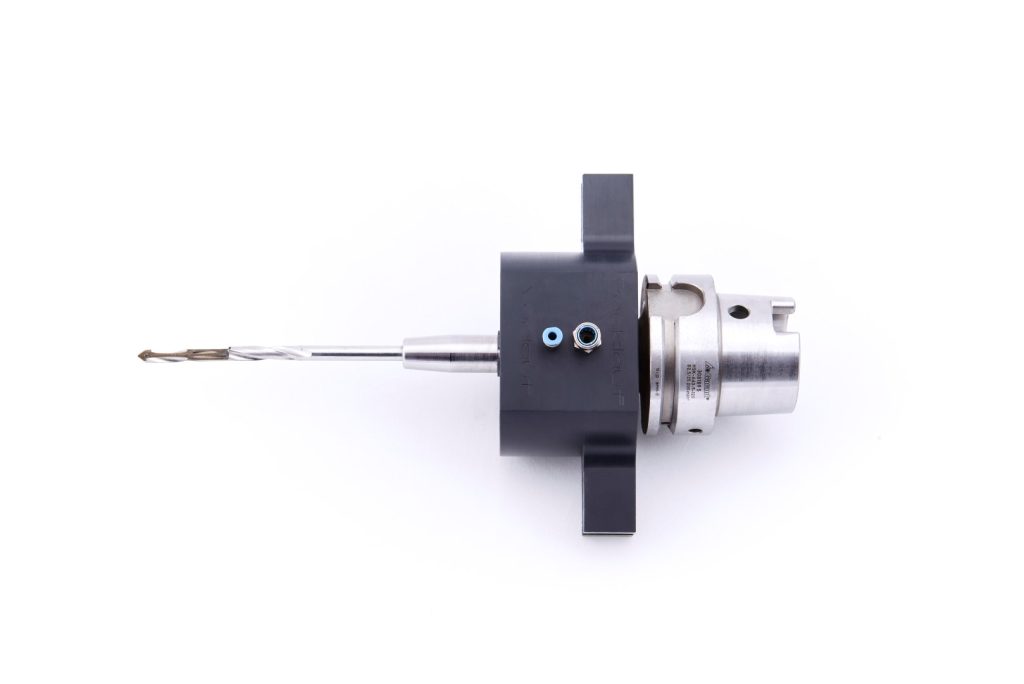

However, thanks to metal laser melting, it is possible to manufacture drills with integrated cooling ducts. This allows the coolant to flow inside the tool – along the helix and back to the toolholder – without coming into contact with the wound. toolcraft also developed a nonrotating prespindle attachment with an inflow and outflow function for the coolant. A continuous supply of coolant is ensured by the attached coolant tank and pump.
The internally cooled prototype was modelled on a conventional bone drill with a diameter of 6 mm. The drill's shape had to be kept the same to make it easier for users to adapt to the new tool. It was also important that the material used is well tolerated by patients. A flow and return pipe ensures a continuous flow of coolant. The internal circular cooling ducts with a diameter of 1.2 mm take the thermal energy away from the cutting edge. Horizontal drilled holes were added, which link the cooling circuit to the drill so that the coolant can be supplied and taken away. A circlip groove is used to attach the manifold. Sealing the two chambers in the manifold posed a further challenge.
