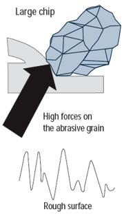

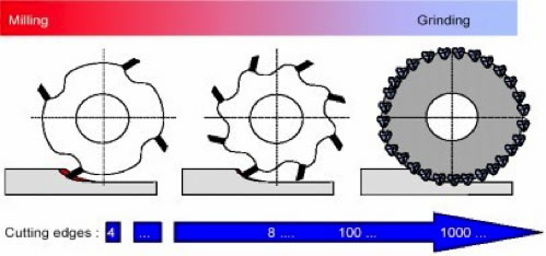

Whether you are grinding HSS or Tungsten Carbide, the flute grinding process is the most difficult feature to grind in round tool manufacturing. Though there are many reasons why, the main reason is that this operation is where most material is being removed from the tool, introducing the most heat and spindle load. There are several techniques that can be used to allow the grinding wheel to perform this operation more effectively. Before these techniques can be applied, understanding the concept of contact surface area and how it relates to force per grit is very important. From a microscopic perspective, a grinding wheel consists of thousands of cutting points. The more of these cutting points in contact with the part being ground, the more the work being done is “shared.” This allows each cutting point to remove smaller chips. As the surface area increases, this will decrease the force being done per grit, and allow the abrasive to continue working until dulling, or abrasive “pull out” occurs. A reduction in chip size will also produce a finer work piece surface finish and will cause the grinding wheel to act harder.
Since the grinding wheel peripheral speed directly affects the number of cutting points in contact with the work piece, a higher wheel speed will decrease the chip thickness, thus reducing the force/grit and causing the wheel to “act” harder. Lowering the wheel speed will have the adverse effect. Another method of lowering the force/grit is through abrasive concentration. Higher abrasive concentration adds more cutting points to the grinding process and would also provide better finishes and cause the wheel to act harder. Lowering the concentration will have the adverse effect.

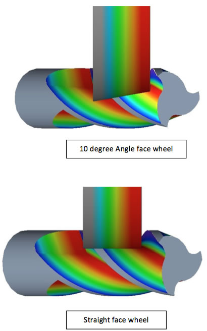

Another way to increase the effectiveness of the flute grinding process is to understand how the approach angle, or “Sku” angle, affects both the grinding wheel and tool being ground and the shape of grinding wheel. In general, an angled fluting wheel will grind with less spindle load than a straight faced wheel. The angled face tends help the wheel penetrate the work material more easily and creates less plowing. In Figure 1 courtesy of Walter United Grinding using Tool Studio shows where the energy is being applied on both the tool and the grinding wheel.
![figure 1](/sites/www.ctemag.com/files/article_images/figure1_0.jpg)
Figure 1
