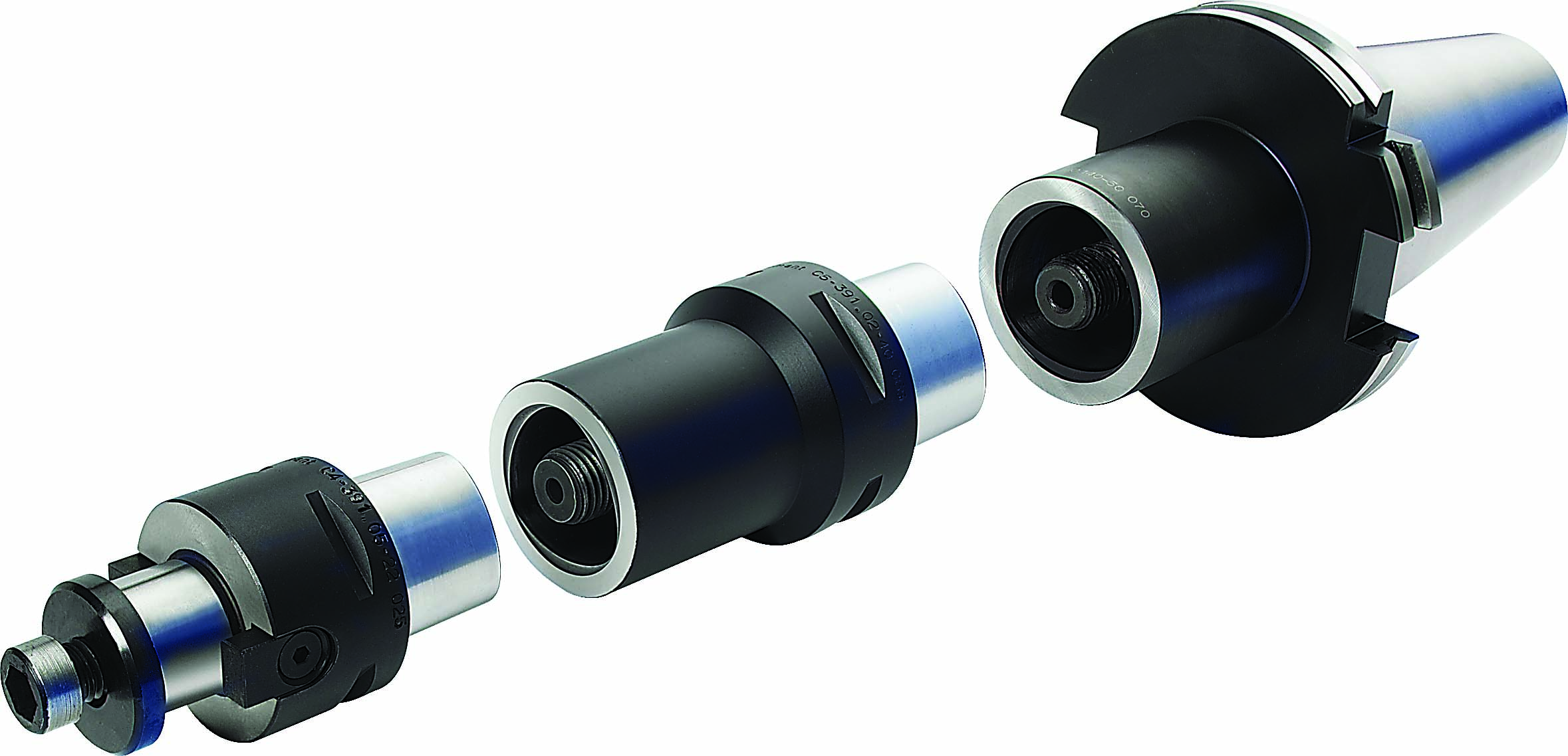

As an option to a single-piece, extended-length holder, several companies offer modular systems that can be built to longer lengths as needed.
“We can build specials beyond the normal catalog size or range, which is usually after 8" or 6" on smaller-taper tools,” Burley said. “But my preference is to direct people toward our CKB line of modular mill/turn tools for mill/turn centers.”
An integrated damping system for extended-reach facemilling eliminates vibration for higher productivity, better surface finishes and higher removal rates. Image courtesy of BIG KAISER Precision Tooling
The advantage of the modular concept, according to Burley, is that there are hundreds of different components that can be assembled together. A CAD/CAM programmer can choose from these to create the optimal tool configuration to fit into the reach and meet the needs of the program.
“It’s kind of like Legos where you start with a basic holder and you can extend it and taper it and do all kinds of things to make it the way you want it to look using standard components,” Burley said. “And the beauty of that is, because you’re using a pool of common components, you can take it apart whenever the job is over and reuse the parts for other builds.”
A modular system normally consists of basic holders with extensions, reductions and toolholder components that fit into them, such as shell mill, collet chuck or endmill holders.
Coromant Capto by Sandvik is another modular system that can be used to create extended-length toolholders. “You can use a Coromant Capto adapter on the machine spindle side and then put different types of milling cutters, drills or boring heads on the machining side of the assembly end of the adapter,” Backus said. “You can add more extensions to make it longer and stack them out as far as you need. On the same tool assembly, you can have different diameters, which gives you a lot of versatility. You usually would start with a larger diameter at the base and then reduce it to whatever you need or just keep it all the same diameter for the entire assembly.”
Of course, modular toolholders bring their own challenges.
“You will sacrifice a little bit of accuracy when you start building up these components, but they’re designed in such a way as to remove the inaccuracy of each connection,” Burley said. “We’ve actually stacked together four or five parts and measured the (total indicator runout) at almost 12" and seen runouts that are less than 0.0005", which is extremely good for any tool.”
Coromant Capto is a completely modular system supporting machine adapters, extensions and facemill adapters. Image courtesy of Sandvik Coromant
Customers also may worry that a modular toolholder is not as rigid as a single-piece one.
“It’s not as good as a solid tool,” Burley said. “But in some situations, because I can build it based on the configuration that I want, I can make it stiffer and larger than a 12" standard holder that is long and slender.”
That scenario is where the versatility of a modular toolholder comes in handy.
“If you’ve got to go around the side of a workpiece but the first 6" is in the dead zone, then we’re going to make that zone as beefy as we can,” Burley said. “Compared to a one-piece holder of exactly the same length and the same exact shape, the rigidity wouldn’t be as good as the solid tool, but I would put it within about 10% of the same range.”

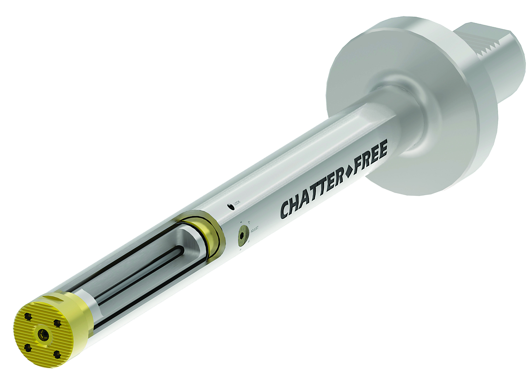

The Need for Extended-Reach Boring Bars
Vibration-damping technologies are for not just longer-length toolholders but boring bars.
“There’s a ton of demand in the oil and gas industry to get much deeper into a bore for ID turning,” said Gregg Bishop of Ultra-Dex USA. “They’re always trying to push that envelope to reach size and finish limits we never thought were possible. Imagine a 40" bore with a standard 4" bar. You can’t do that with a traditional carbide shank boring bar.”
He said oil and gas applications use threads with a high insert engagement, which creates a lot of deflection when cutting, and therefore vibration occurs even at short bar lengths.
In response to demand, Ultra-Dex developed a chatter-free line of boring bars with up to a 14-1 ratio. These long-overhang ratios are made possible by an internal damping technology based on a high-density alloy that provides optimal dynamic stability.
“They can run at higher speeds and feeds versus a plain carbide or steel boring bar with the same hangout ratios,” Bishop said. “It’s a productivity booster, so the (return on investment) on the added cost is found where the customer takes into consideration the increased throughput.”
