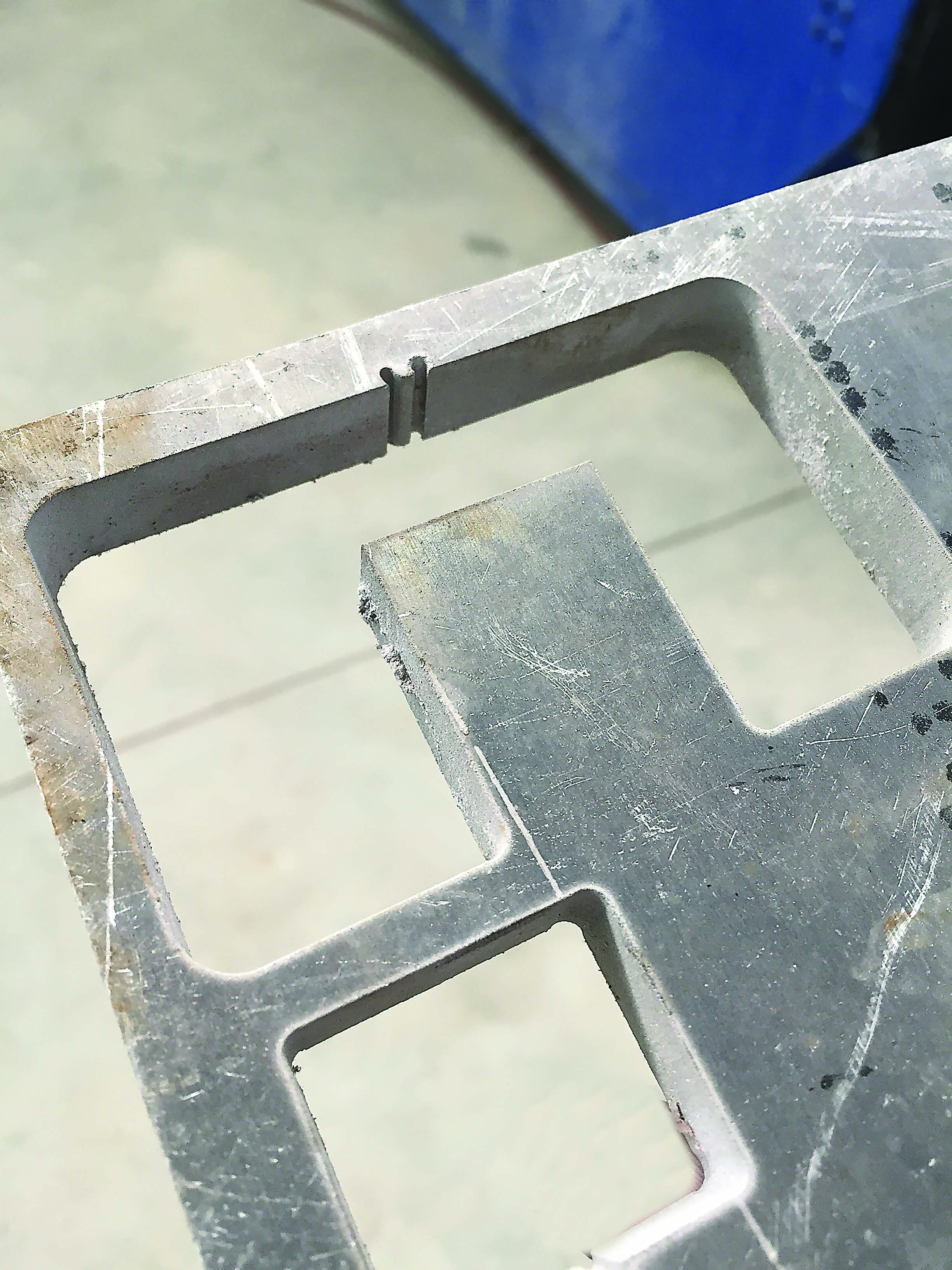

T.J. Johnson,engineering manager of the manufacturing division at Fitz-Thors Engineering, holdsa sample workpiece to point out entry and exit points for an interior part. Image courtesy of Fitz-Thors Engineering.

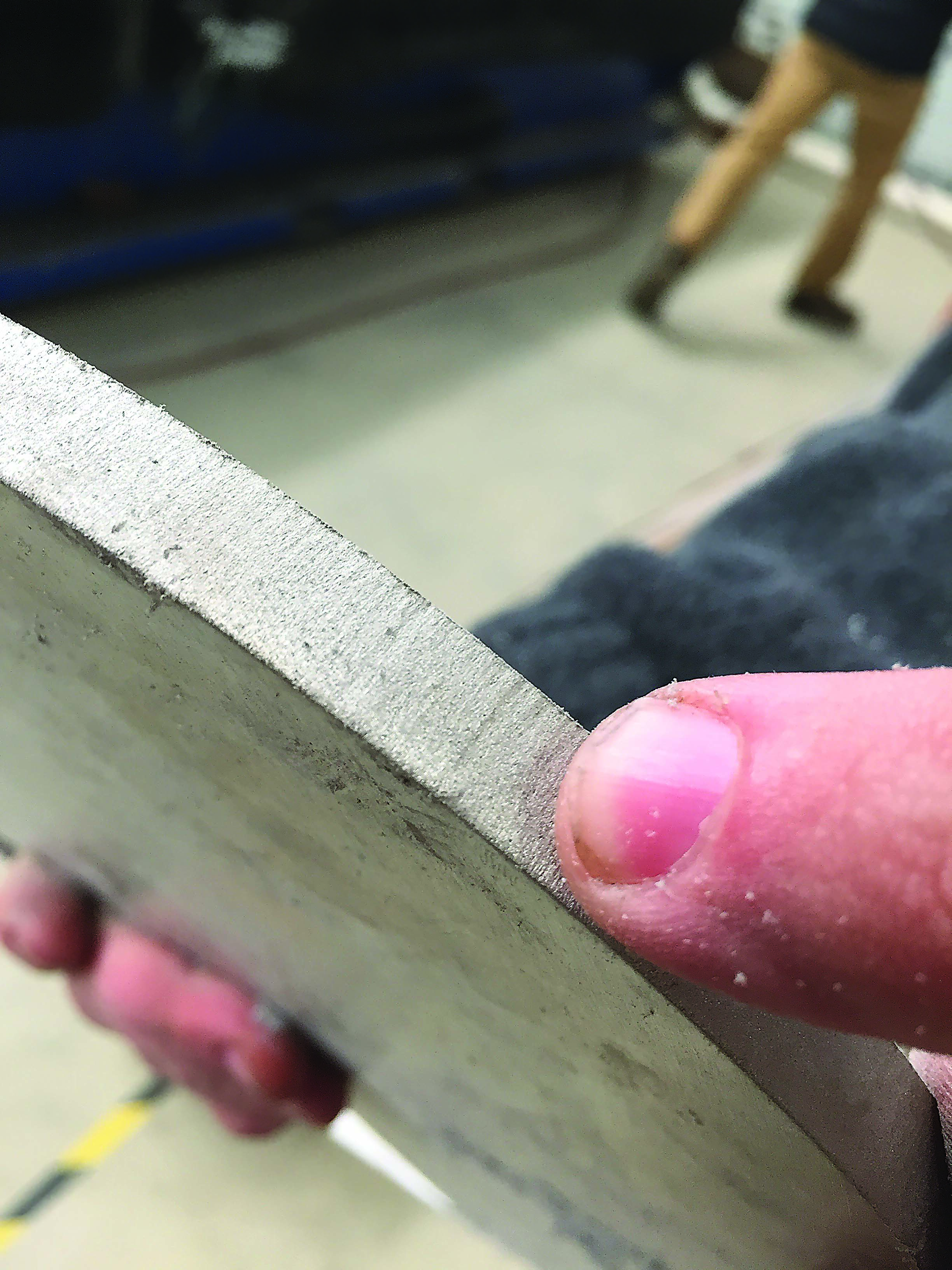

T.J. Johnson points to ridges on a part that result from spray moving quickly through a cut, which, depending on the part’s intended use, could cause problems. Image courtesy of Fitz-Thors Engineering.

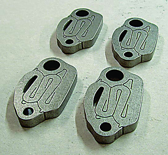

A stainless steel safety device with various features cut by waterjet, such as the indentations that allow it to give under pressure, decreasing impact force. Image courtesy of Rocky Mountain Waterjet and Laser.
