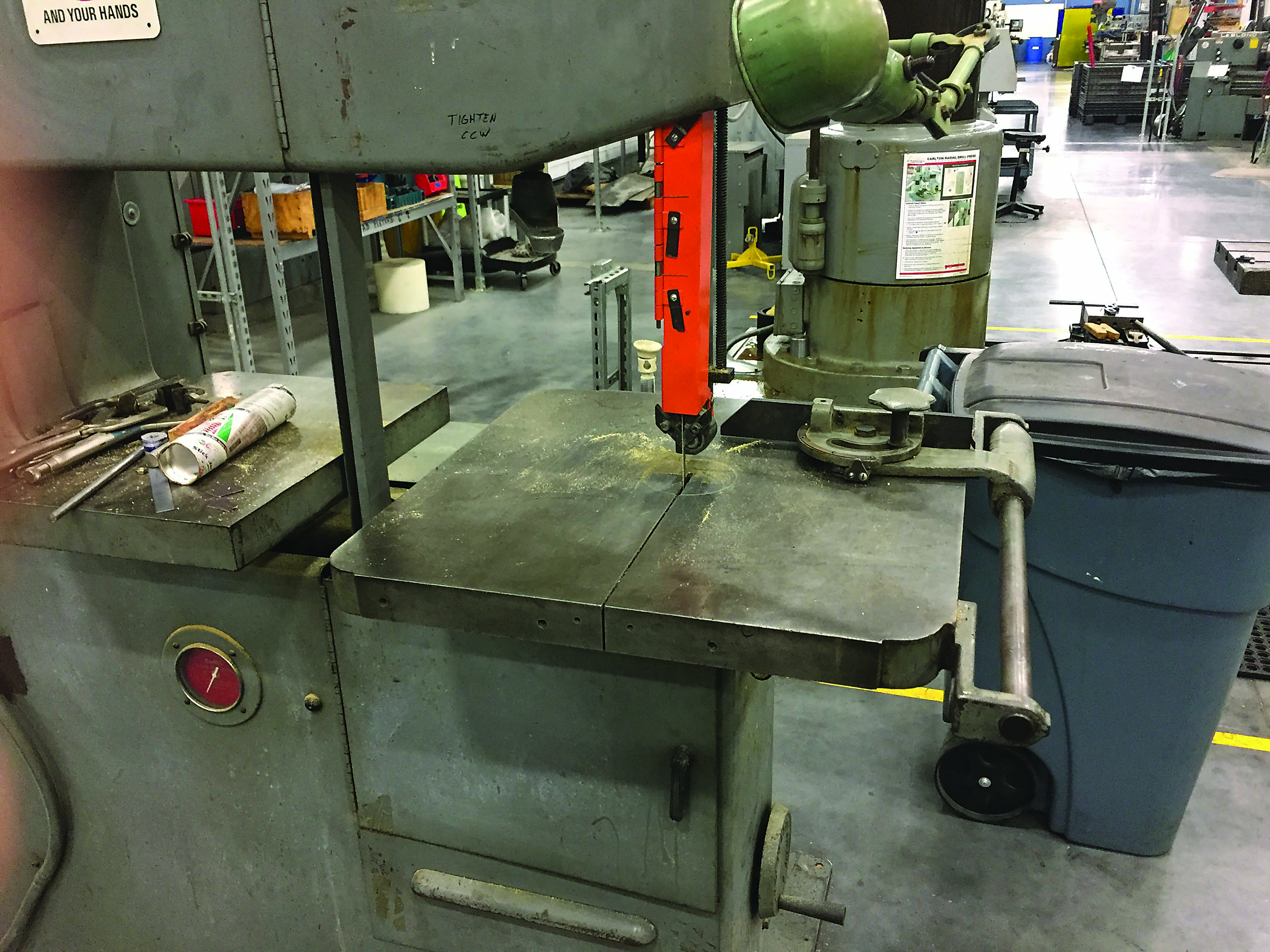

This vertical saw has several attachments to assist cutting, such as the miter attachment shown on the saw table. All images courtesy of C. Tate.

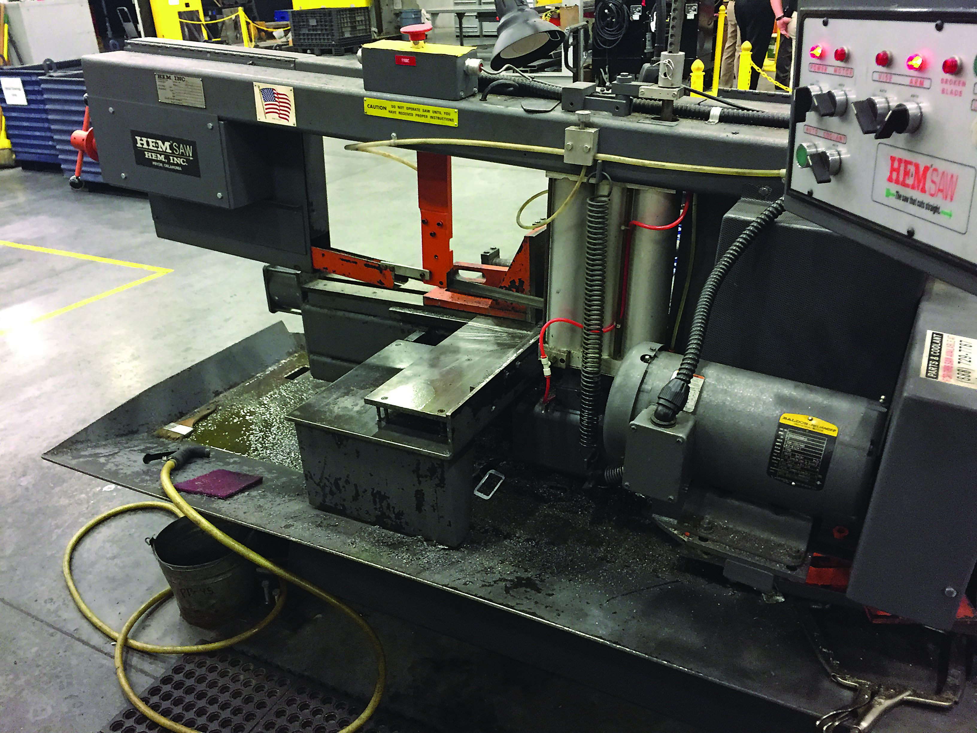

A horizontal bandsaw presents the saw blade to the workpiece in a plane that is parallel to the floor. Because of the approach angle of the blade, a horizontal saw is well-suited for cutting long materials, such as bar, tube, pipe and structural shapes, to the desired lengths.
In contrast, a vertical bandsaw presents the blade to the workpiece in a plane that is perpendicular to the floor. It is best-suited for cutting shapes from flat materials, like plates and sheets.
The traditional vertical saw is manually operated. Therefore, it is well-suited for cutting shapes out of plates. While not impossible, it is improbable that an automatic saw would be used to rough components before machining. Manual saws are more suitable for this activity in toolrooms because of low part volumes. Other methods, possibly waterjetting, would be used for similar tasks in a production setting.
At Mitsubishi’s valve shop, this horizontal bandsaw is used more than the shop’s two other saws.
