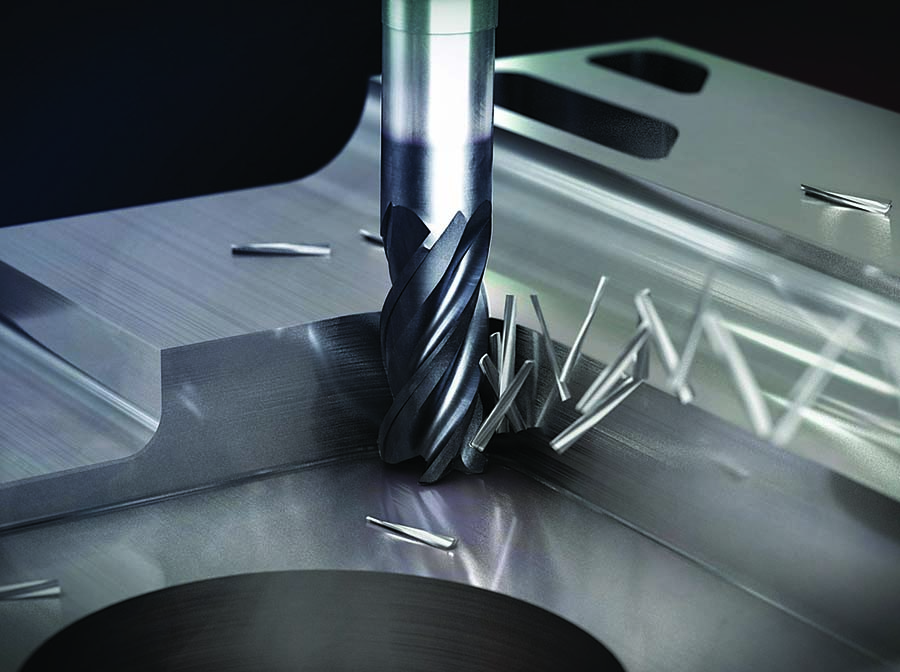

Bruhis said those comparing the designs of typical general-purpose and high-performance endmills will notice significant differences in the flutes on the tools. For one thing, he said, general-purpose endmills normally have two to four flutes while high-performance tools probably will have at least five and possibly as many as 12 flutes. In addition, he noted that high-performance endmills have unequal index and variable helix angles to minimize vibration. So while all the flutes on general-purpose endmills will have helix angles of about 30 degrees, a high-performance tool might have a couple of flutes with 37-degree helix angles and a couple with 35-degree helix angles, he said.
An exception to this rule, however, is Emuge-Franken’s Top-Cut VAR. Billed as a multipurpose endmill, Doiron said Top-Cut VAR features flutes with variable helix angles that provide significant vibration dampening.
Other features that generally distinguish high-performance endmills from general-purpose alternatives include special coatings and edge preparation. When it comes to coatings, Bruhis said general-purpose endmills normally sport common coatings, such as AlTiN and TiCN, while high-performance tools might get a special coating like TiAlSiN or AlCrN.
Regarding size options, general-purpose endmills usually offer more than their high-performance counterparts. He said one of the biggest advantages of general-purpose endmills is that they come in diameters down to 0.396875 mm (1/64") while high-performance tool diameters commonly go only as low as 3.175 mm (1/8") or 6.35 mm (1/4").

Besides supplementing general-purpose endmills with higher-performance tools in some cases, shops now can opt for general-purpose tools that offer better performance thanks to additional flutes. While the traditional general-purpose mill was limited to four flutes, Doiron noted that some styles now feature five, six and even seven flutes.
“This trend of higher flute count is based on toolpaths developed by CAD/CAM suppliers promoting large axial depths of cut with light radial passes,” he said. “We as cutting tool manufacturers are developing tools to support the concept.”
