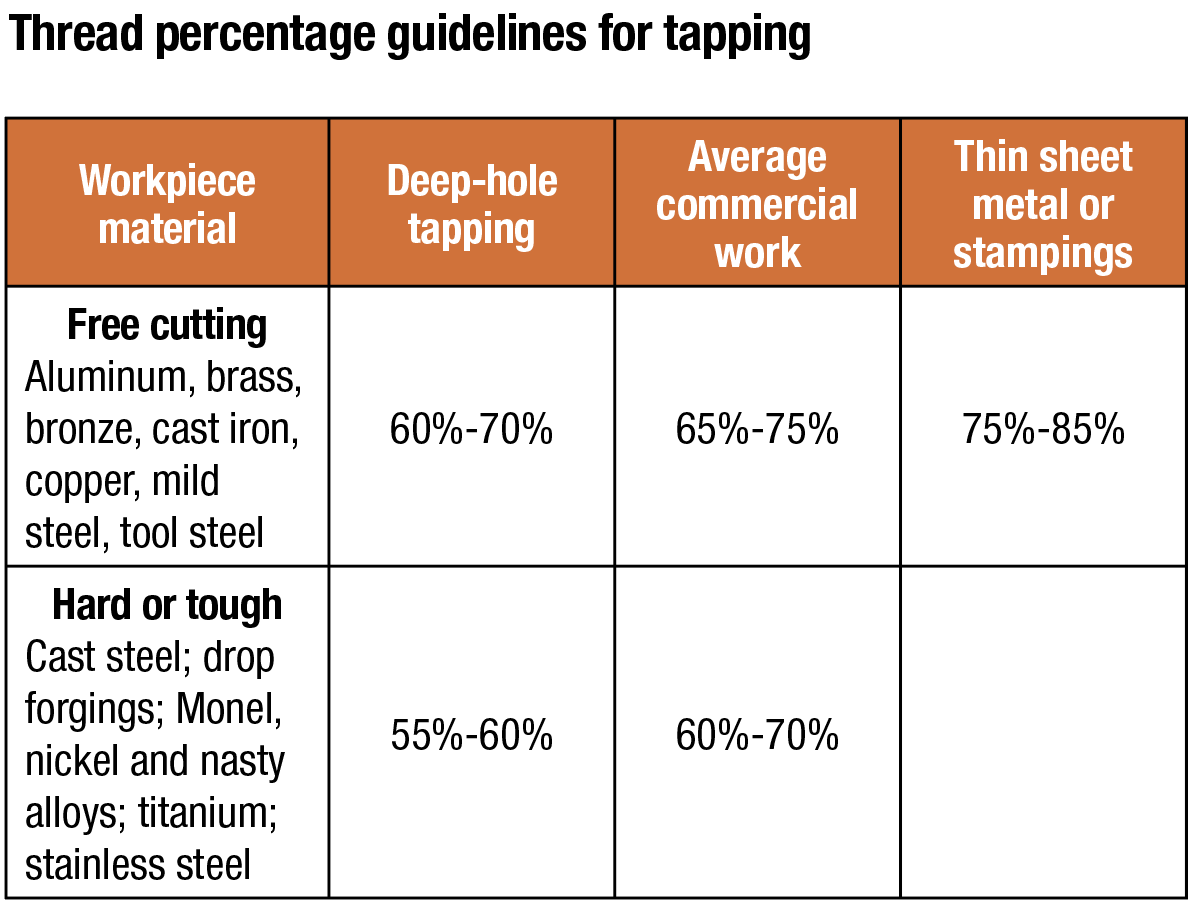

Thread percentage guidelines for tapping are based on different conditions.
Thread percentage guidelines for tapping are based on different conditions. Image courtesy of B. Warfield

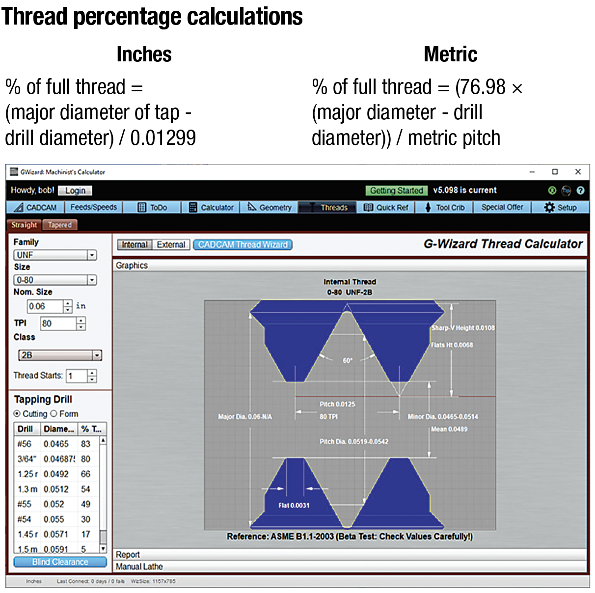

Calculating thread percentage is easy.
Calculating thread percentage is easy. Image courtesy of B. Warfield
The table about thread percentage guidelines for tapping gives advice based on different conditions. Dial back to less than 75% when tapping deep holes. Dial back for hard, tough materials too.
Make sure to check the requirements of the job. A customer may need a particular thread percentage. But if not or if the work is within the ranges in this table, back off the thread percentage, and your taps will thank you.
Calculating thread percentage is easy. The formulas are found in the figure about thread percentage calculations. Or you can use a handy tool like the G-Wizard machinist’s calculator, which is pictured in the figure.

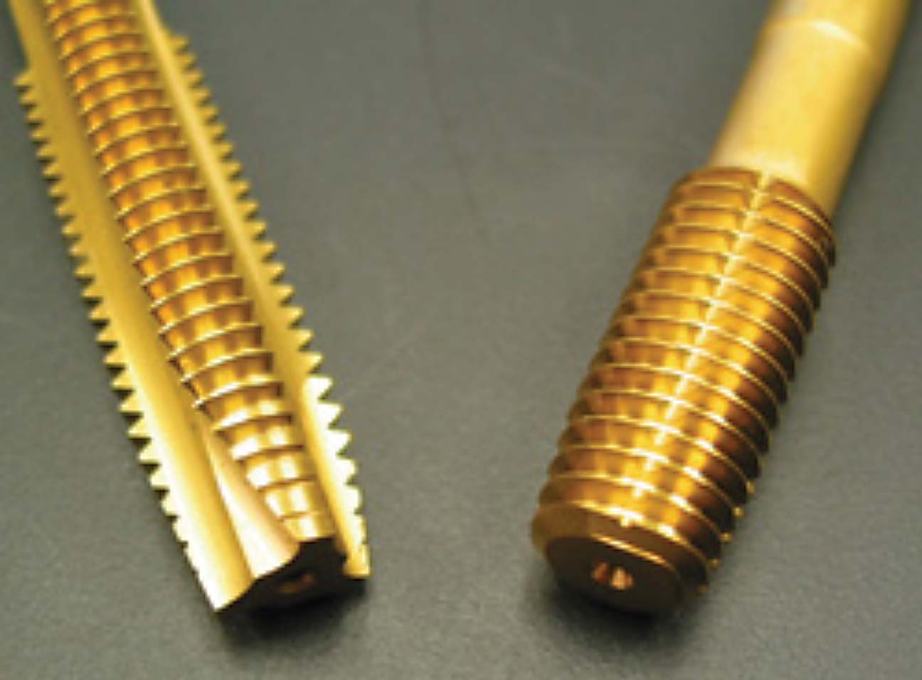

Use form taps whenever possible.
Use form taps whenever possible.  Image courtesy of B. Warfield
2. Use form taps whenever possible.
They don’t generate chips, and they push material into shape, cold forming the threads. The most common reason why taps break is because they become bound up in their own chips, which can’t happen with a form tap. Form taps also have a greater cross section, so the taps themselves are stronger than cutting taps.
Form taps have two disadvantages. First, form taps can’t be used on hard materials. You can form-tap materials up to only 36 HRC. That’s a lot more materials than you might think, but there are definitely materials that can’t be form-tapped. Second, some industries don’t allow form taps because the process may create voids that trap contaminants on the threads. Form tapping also can result in stress risers on threads.

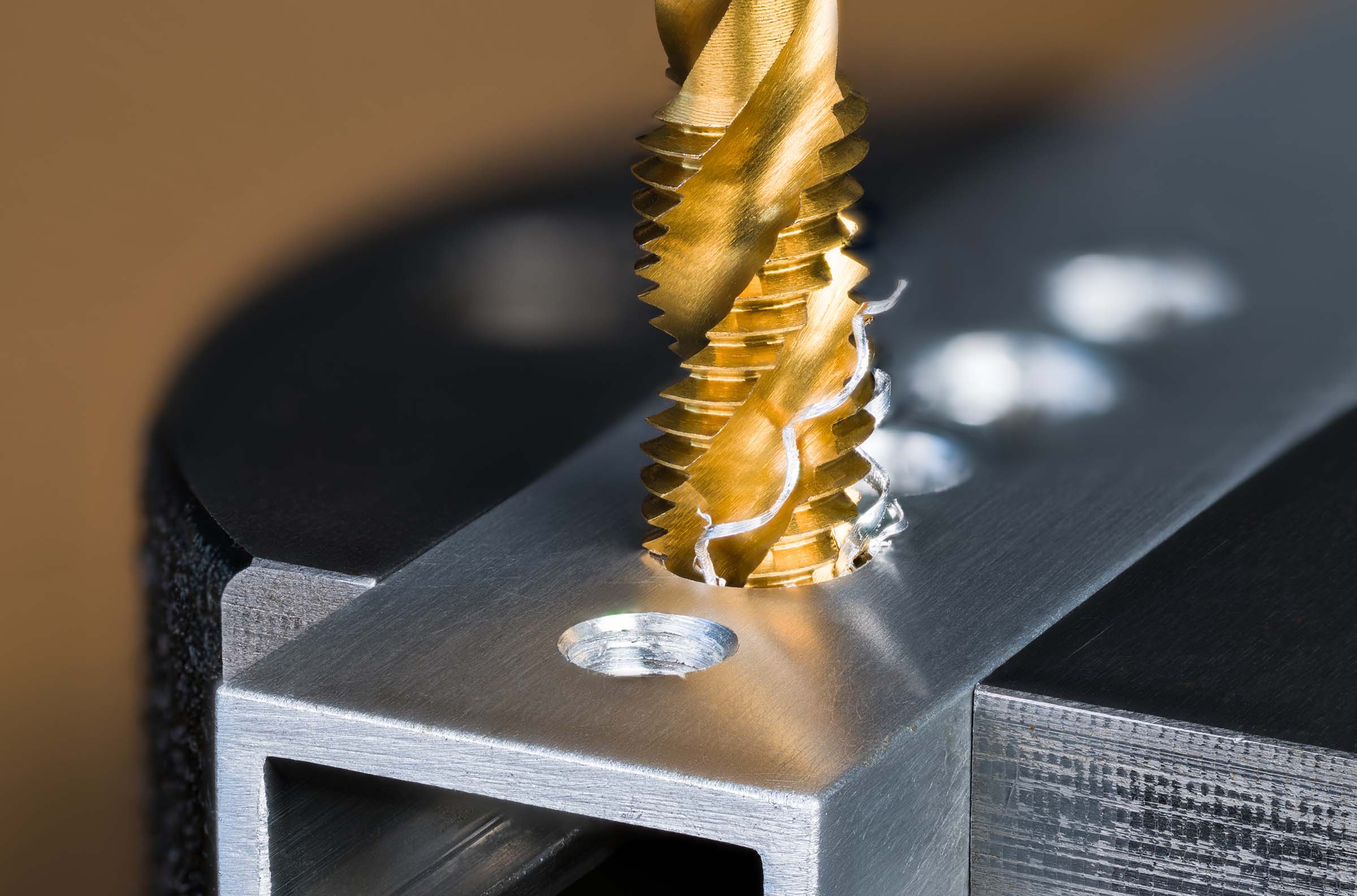

6. Use spiral-fluted taps when appropriate.
If you’re tapping a blind hole, failure to extract chips is the most common reason that taps are broken. That’s why we use spiral-fluted taps. They eject chips up and out of a hole. Note that spiral-fluted taps are not as strong as the more common spiral-point taps, which is why spiral-fluted taps are not used all the time. Use them just for blind holes.
