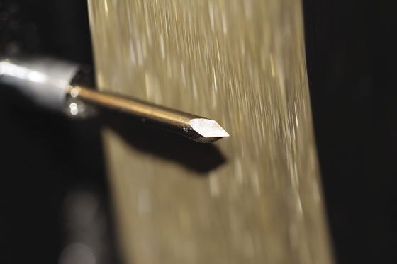

The raw wire used for surgical needles—typically a precipitation-hardening stainless steel—is fed from coil stock, straightened and cut to length before being dropped into a magazine, which in turn feeds the needle blanks into a half-moon-shaped saddle, where they are ground to shape. Next, depending on how the needles will be used, they may go to a bending operation and, finally, to heat treatment and polishing.
Hypodermic needles are made in much the same manner, except the grinding wheel arrangement is similar to that of a surface grinder rather than a cylindrical grinder. Both types of needles are made with a variety of points, all of which are designed to puncture skin with minimal pain.
Selbach explained that the company generally applies a 4 "-dia. (101.6mm) CBN or diamond wheel without coolant to remove a minimal amount of material.

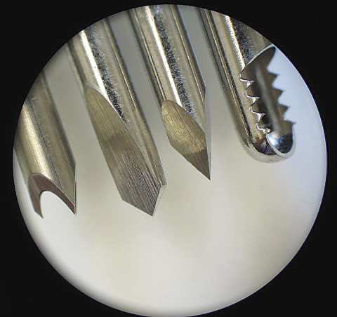

Needles are just a few of the ground instruments that surgeons and other doctors rely on every day. They also use trocars and cannulas, guide wires and scalpels, tweezers and bone cutters. Modern medicine would be in the dark ages without microgrinding.
Jim Boldig, product engineer for Modern Grinding Inc., a medical guide wire, pin and needle manufacturer in Port Washington, Wis., said the company routinely grinds solid wire and hypotube—the tube stock used to make hypodermic needles—down to 0.006 " (0.152mm) in diameter and to tolerances of ±0.0002 " (±0.005mm).
The needles’ smallness is one of the big challenges of manufacturing them, Boldig explained. “Most [parts] have to be viewed under a microscope during manufacturing, sometimes to 200× magnification. Proper handling is critical—bending, pulling or even the wrong packaging can cause permanent damage.”

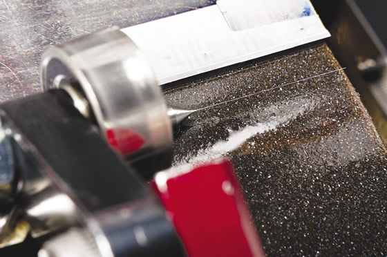

Likewise, cutting conditions such as wheel speed, infeed rate and traverse rate must be closely monitored. “A wrong [input] will cause faster wheel wear or a painfully slow process,” Boldig said. “It’s always a tradeoff between the two, and the trick is finding the sweet spot.”
Someone who knows how to find that sweet spot is John Shegda, president of M&S Centerless Grinding Inc., Hatboro, Pa. The company centerless-grinds everything from valve spools and core pins to injector needles and motor shafts.
A unique process at M&S is Swiss-style grinding on a hybrid machine that situates a grinding wheel directly in front of a guide bushing and collet mechanism. “The collet grips the wire and feeds it through the guide bushing,” Shegda explained. “The grinding wheel basically acts as a turning tool, allowing you to interpolate a variety of forms.”

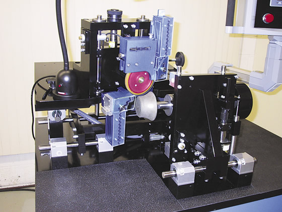

Tru Tech Systems Inc., Mt. Clemens, Mich., is another machine tool builder serving the microgrinding industry. To support its own grinding needs—Tru Tech is also a job shop—as well as those of its machinery customers, the company has developed a workholding process called Perimetric grinding.
“It’s similar to centerless grinding,” said Steve Smarsh, Tru Tech president. “We use a work blade, regulating roller and a grinding wheel, of course, but we’ve also added a pressure roller, strategically placed to support the workpiece.”
TruTECH_DSC5788%20EDIT.tif
Courtesy of Sheldon Buchler, Tru Tech Systems
A tension roller holds a 3mm shank against the guide blade and regulating roller, holding the part for Perimetric grinding.
Smarsh claimed Perimetric grinding is the most accurate way to hold a workpiece. “We can hold tolerances down into the millionths with virtually none of the triangulation seen with conventional centerless grinding machines,” he said.

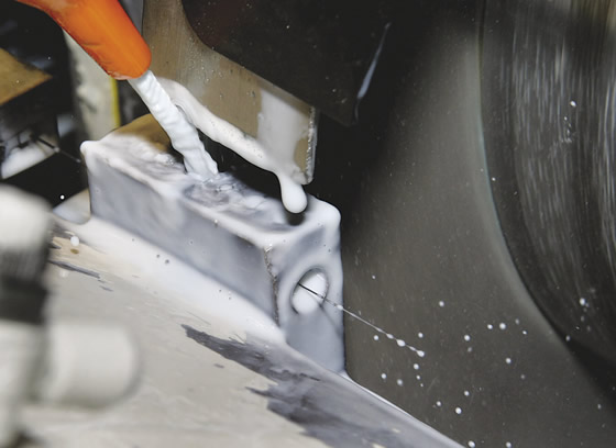

He’d be happy to sell you a new machine—an autoloader version capable of both centerless and OD grinding goes for around $219,000—but you can also buy a Perimetric grinding attachment to use on your existing equipment for $9,000. CTE
