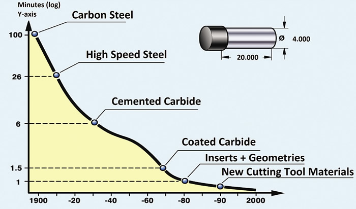

HSS is a very tough, but not very wear-resistant, material. HSS tools are applied in many common, demanding applications.
Carbide is the most widely used wear-resistant cutting tool material and is suitable for making solid tools and indexable-insert tools. Approximately 85 percent of all carbide indexable inserts are coated.
The development of cutting tool materials and designs since 1900, and the number of minutes it takes each type of material to turn a component that measures 20” long and 4” in diameter.
