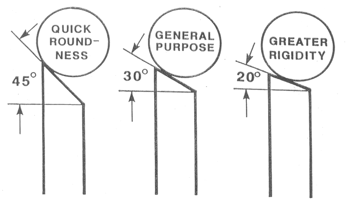

The top angle on the workrest blade helps with the rounding action of the part. With increased angle, quicker rounding occurs, but it also weakens the blade rigidity. The most common top angle used in centerless grinding is 30 degrees. As the diagram below indicates, lower angles are used when grinding heavy workpieces, which help minimize vibration. Workrest top angles typically range from 45 degrees down to 20 degrees. Generally speaking, 30 degrees is a good starting point for the majority of parts to be thrufed centerless ground.
