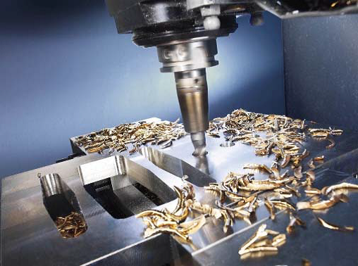

The shavings are virtually residue-free and can be recycled directly. Photo credit: bielomatik Leuze
The shavings, which are produced when machining using minimum quantity lubrication, are virtually residue-free and can be recycled directly. Photo courtesy of bielomatik Leuze

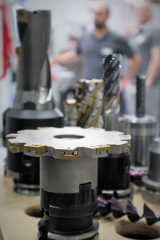

There are no widespread substitutes for the classic cooling lubricant concepts as yet. Photo credit: ISF
There are many successful examples of dry machining in individual industries or companies. However, there are no widespread substitutes for the classic cooling lubricant concepts as yet. Photo courtesy of ISF

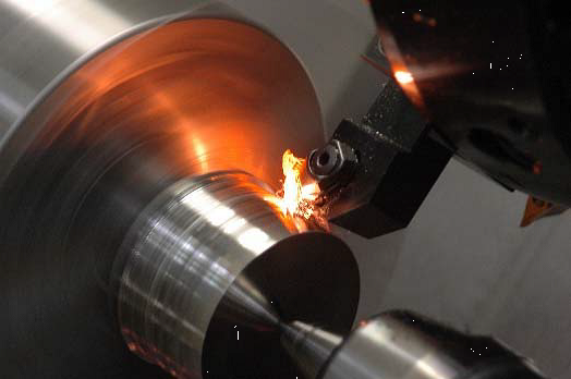

You should take a holistic view when deciding whether to deploy dry or MQL machining or whether a classic process should be used. Photo credit: Dag Heidecker
Users are recommended to take a holistic view when deciding whether to deploy dry or MQL machining or whether a classic process should be used. Photo courtesy of Dag Heidecker
