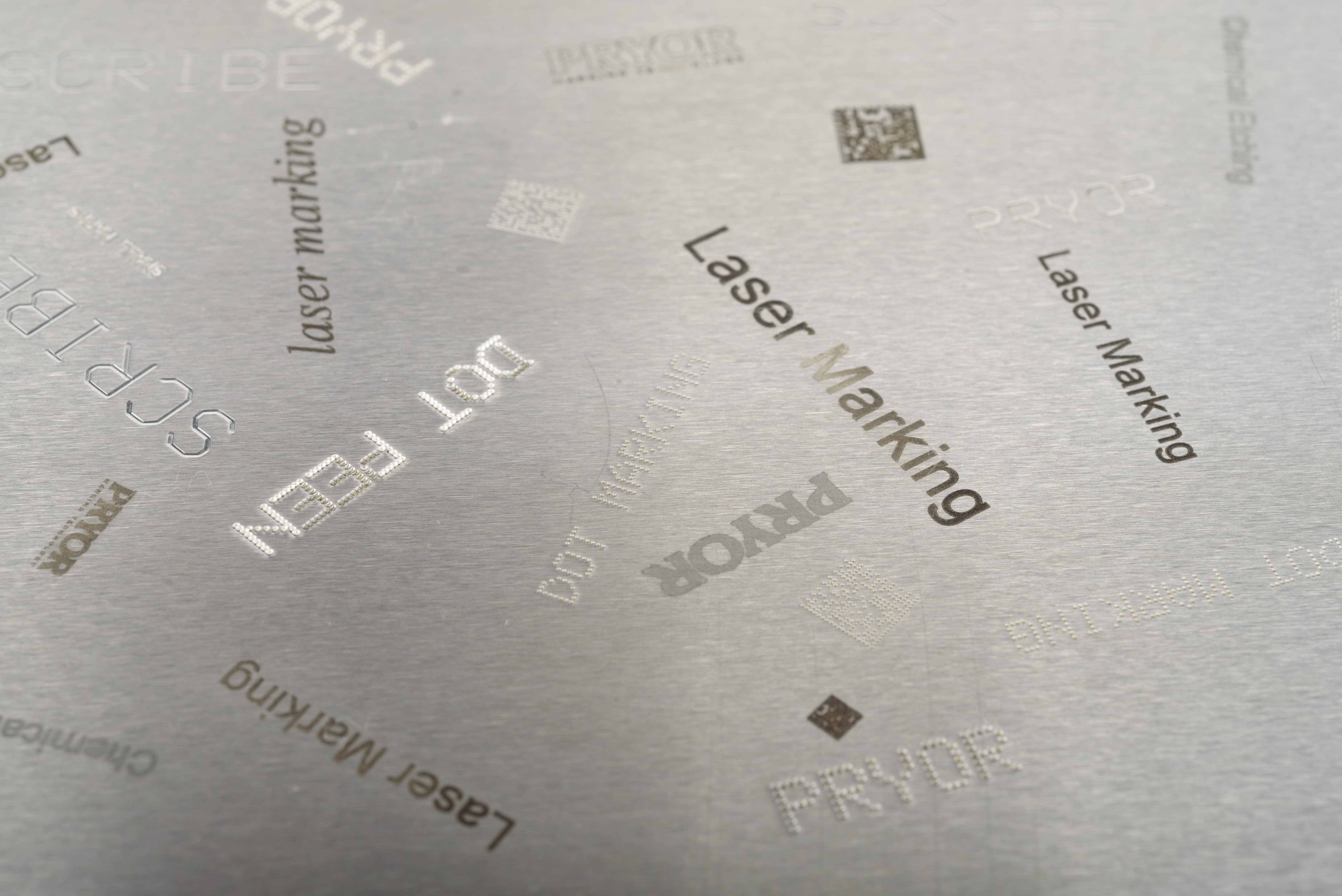

Making these kinds of marks requires a sophisticated approach. Static marking techniques such as scribing or dot matrix cannot easily be used in-line as part of a continuous automated manufacturing process. Laser marking systems are usually fully automated, for incorporation into production lines, but the time it takes to make each mark is still long enough to slow down cycle times.
One way to overcome this problem is to mark 'on-the-fly', tracking and marking each component as it moves along the line. During the process, a laser makes a precise, indelible mark without stopping production. This is an enormous advantage, as it maintains a low cycle time.

Firstly, the system must ensure that the mark, which itself may be complex, is of suitable quality and is made in the correct place. For instance, marks must be permanent, indelible and clearly legible and may have to be made several times on a single component. They may also have to be made in predefined locations, within a marking 'window', typically around 0.16 inches square (100 mm2).

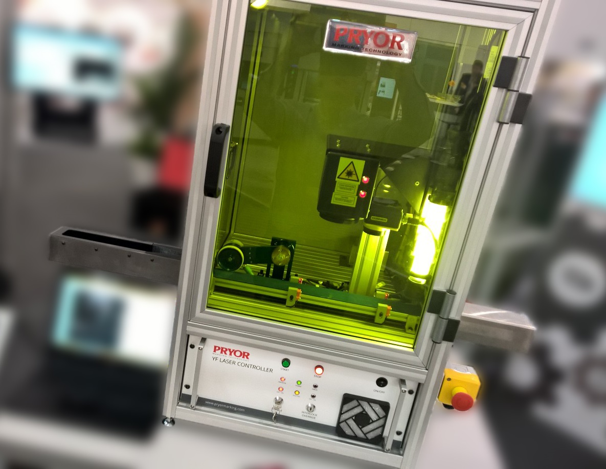

High energy fiber lasers offer several advantages in high speed marking. Flexible optical fibers allow maneuverability, which helps to deliver the beam to a moving focusing element. At the same time, fiber lasers can deliver beams powerful enough to make permanent marks, on resistant metals such as hardened steel, in a fraction of a second. In most cases, while the time allotted to make a mark is 0.5s, it is usually achieved within 0.2s.
A laser with higher power can be used if moving to even higher line speeds. This allows marks of enough depth and clarity to be made over a shorter period of time. Alternatively, the marking window can be expanded, which gives more time for a mark to be made.
It usually takes no more than half a second to mark a component with a complete, machine-readable Data Matrix code, a unique identifier for each component or section of material.
