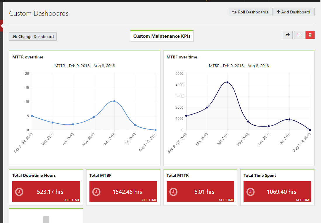

Replacement Part Reliability
One way to utilize the data already stored in the CMMS is in replacement part reliability. Using this platform to its fullest extent, tracking different part data becomes possible. This data could include:
  • time of service
  • downtime for replacement
  • failure mechanism
This continues the theme of “holistic maintenance.” Every one of these factors can be considered in part purchasing. Purchasers may be merely working from part cost. This would be akin to only tracking maintenance department spend. There are many other factors to consider for optimizing the operation.
For example, a reliability centered maintenance (RCM) approach to failure modes may find that the part in question needs more robustness.  Perhaps the part composition is the not the optimal material for the process. Rather than saving money on the part, replacing with a more durable part will save money for the entire process.
We saw this example at our client’s facilities. They were “saving” pennies on replacement gaskets, filters and bearings, while losing hundreds of dollars in downtime replacing them. There was a disconnect between the parts ordering and the operations and engineering team.
In one instance, they noticed how they are repeatedly losing pumps on a specific line due to bearing failure. After some basic analysis, the conclusion was that the bearings they were using were not rated for the temperature during part of the process. The process had been changed at some prior time and the equipment had not all been updated along with the change. They simply upgraded the bearings and the problem was solved.
However, it is not always easy to make this connection. A modern CMMS platform can certainly help. Purchasers should be trained to periodically question the parts that they are ordering. There should be regular dialogue between the operations, engineering and the purchasing team.
If you are unsure of how to start this analysis, a simple method is an A/B test. Conduct it on two similar machines or the same machine at different times. Test the replacement parts using the CMMS to track service time and failure metrics like MTBF
