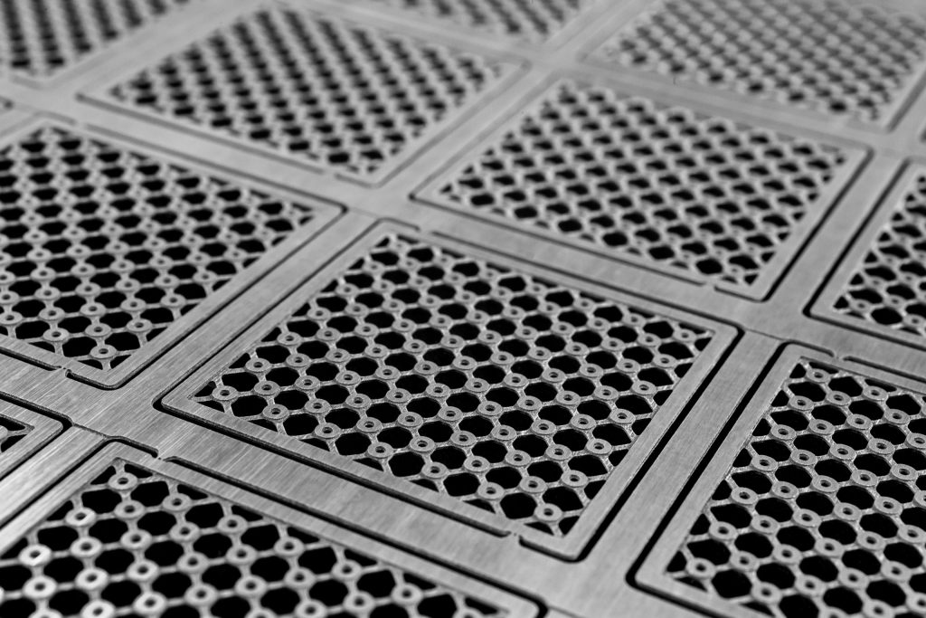

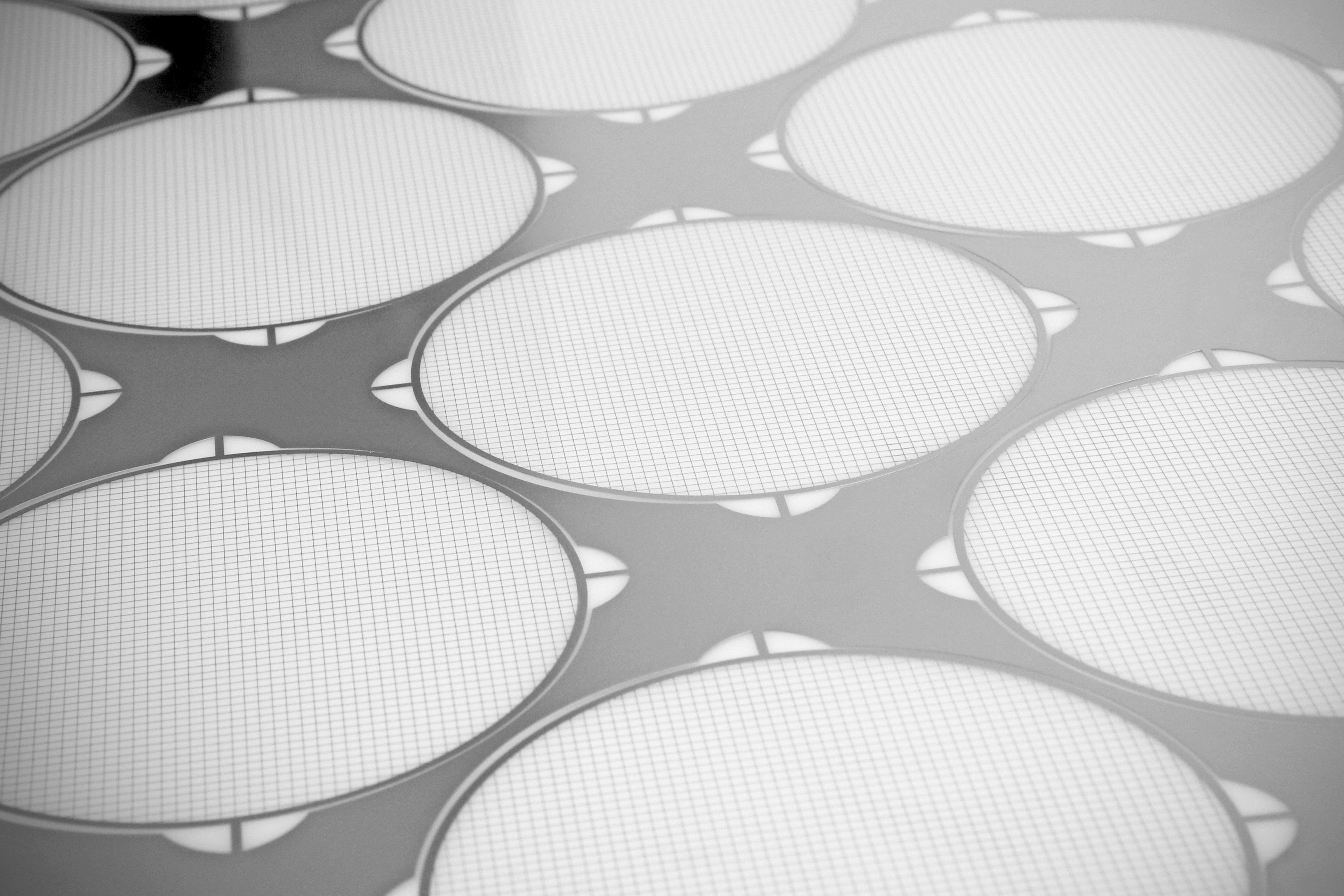

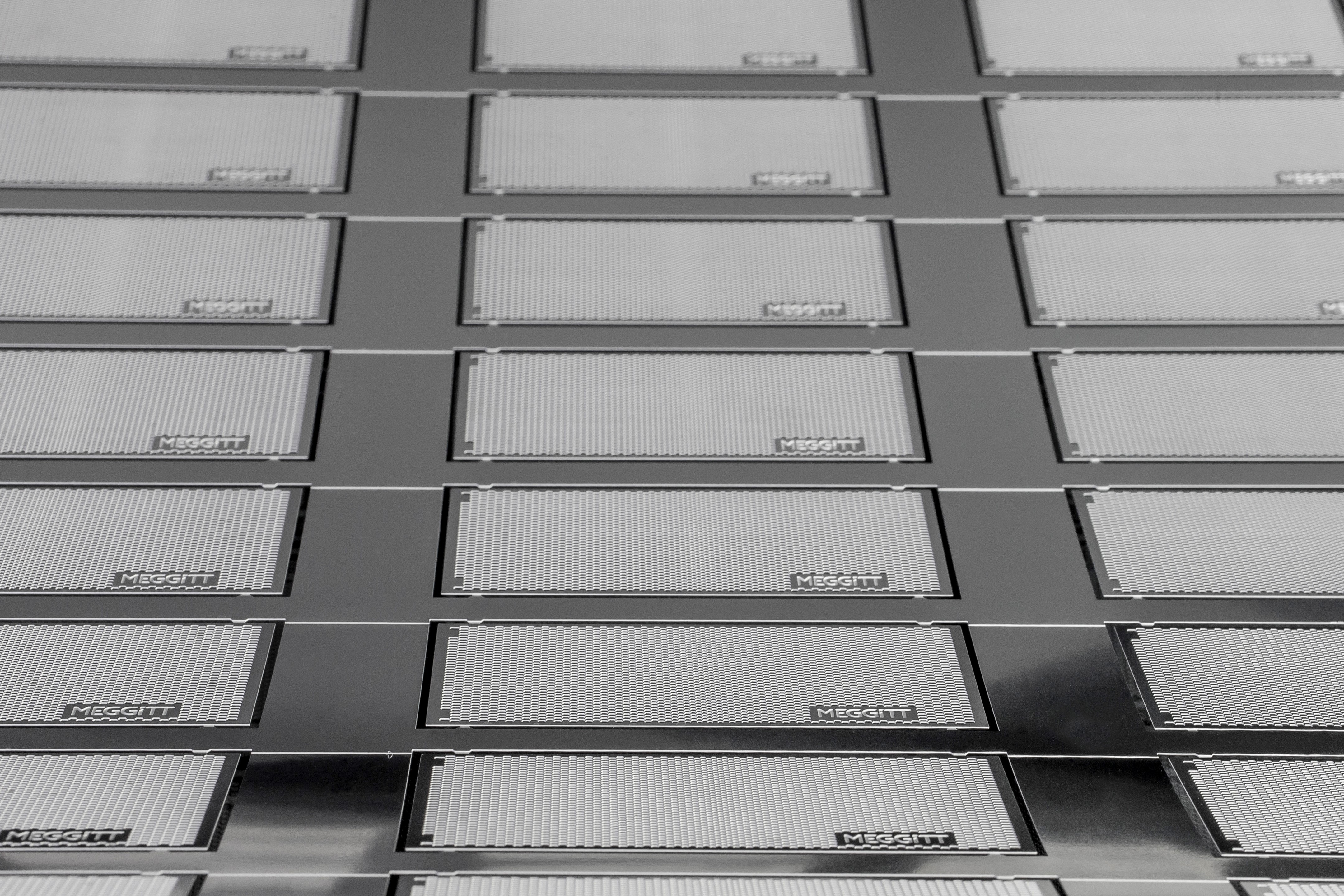

Photo etching is also used extensively in the manufacture of custom steel meshes, filters and sieves as, unlike conventional sheet metalworking, the process offers unlimited complexity—you only pay for the first hole. Also, as photo etching does not alter the mechanical surface finish of stainless steel, it has been adopted by automotive interior trim designers for the manufacture of complex and detailed premium automotive speaker grilles.

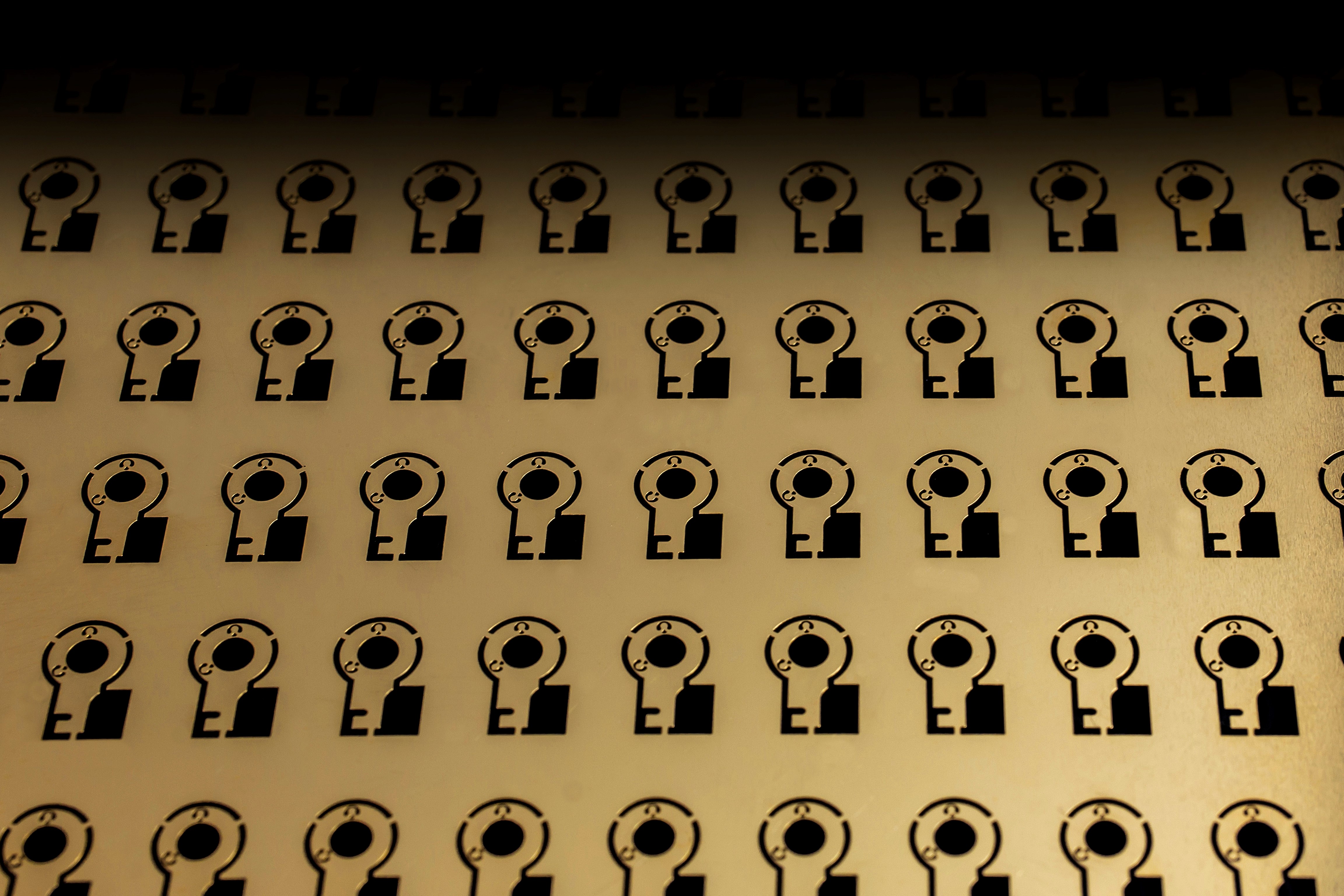

Nickel silver is the most cost-effective material choice for electronics shielding as it can be soldered, will not oxidise and requires no additional plating. Digital photo-tooling offsets expensive press tools, and bend lines can be incorporated so components can be formed by hand.
