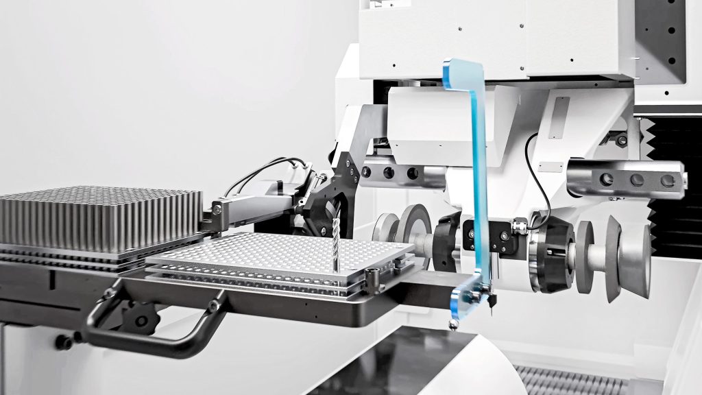

Automation ready
For maximum productivity, a loading system is available: the "Top Loader" is directly integrated into the work envelope of the machine for easy access and therefore requires no additional floor space. Suitable for tools from 3 mm to 16 mm (0.118" to 0.63") in diameter, the maximum tool capacity of the loading system up 500 tools for tools with a 3 mm (0.118") diameter. The Top Loader uses WALTER-standard robot pallets and automated electrical teaching.
