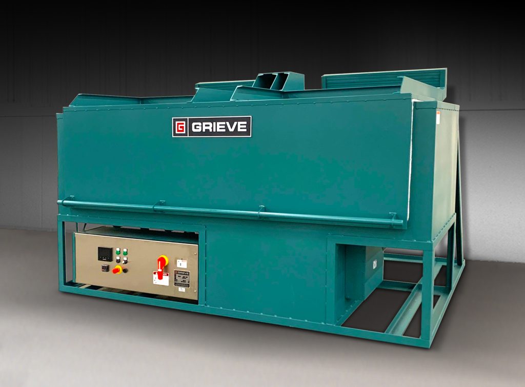

The Grieve top-loading oven features 6" insulated walls, 16-gauge aluminized steel interior and a bottom reinforced for 800 lb. capacity. Additional features include a heat chamber mounted below the workspace and a pneumatic "L" shaped door.n
This Grieve oven is a 500°F (260°C) top-loading, electrically heated oven, currently used for heat treating parts at the customer's facility. Workspace dimensions of this oven measure 96" W x 20" D x 20" H. 18 KW are installed in Incoloy heating elements, while a 2 HP blower provides back to front airflow to the workload.
This Grieve top-loading oven features 6" insulated walls, 16-gauge aluminized steel interior and a bottom reinforced for 800 lb. capacity. Additional features include a heat chamber mounted below the workspace and a pneumatic "L" shaped door.
Controls on this Grieve oven include a programmable temperature controller, separate heating element control contactors, a disconnect switch and a power controller to ensure precision proportioning of electric power to heating elements.
