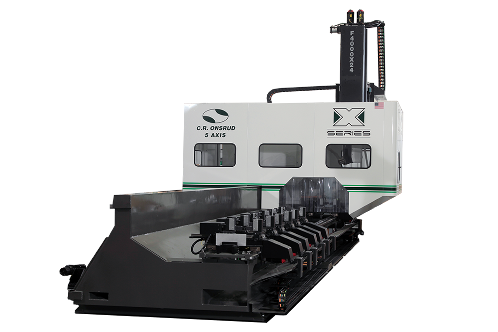

C.R.Onsrud introduces and demonstrates a machining center designed for complex machining and sawing of
extrusions. This machining center is able to process five sides of thick-walled extrusions and index parts by using its independent servo programmable clamping system. The optional large capacity saw is available for material cutoff and mitering.
“The XSeries was our response to customers looking for a solution to machine heavier wall extrusions who need the reliability and support that could only be delivered by an American manufacturer,” says Jeff Onsrud, directory of sales and business development for C.R.Onsrud.
C.R.Onsrud Xseries F4000X machining center specifications include: X travel of 244 inches, Y travel of 54 inches, Z travel of 42 inches; overall length of 310 inches, overall width of 152 inches, overall height of 180 inches. Onsrud’s modular base allows for longer length machines if needed.
F4000X machining center features a 24 HP Spindle at 24,000 RPM (with optional 33 HP); Control is FANUC 0i; Tool Management is 12-position rotary standard (with optional 24-Position Quick Change); Scrap Handling by Chip Pan standard (with optional Chip Conveyor); Material Handling is by Servo Positioned Clamps. Additional optional features include: Robotics Integration, Aggregate Capable, 500mm Saw Blade, Auto Tool Measurement, Linear Scale Feedback.
