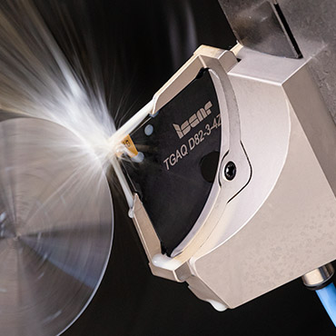

A highly advanced parting system for square TANG-GRIP (TGAQ ) adapters that fit onto a unique crown clamping mechanism with a single screw for fast clamping and indexing.
Features:
  • Two coolant through tools with top and bottom outlets for output pressure of up to 340 bars.
    Significantly improves insert tool life.
  • Quick, change fast and easy adapter indexing. User-friendly with a single clamping screw.
  • No set-up time after blade or pocket indexing.
  • Can be used next to the spindle or next to a shoulder as the square adapter and tool shank align with no protrusions.
  • Economical adapters with 4 pockets for TANG-GRIP 2,3- and 4-mm width inserts.
  • Suitable for all TANG-GRIP inserts including high feed inserts. Designed for higher productivity.
  • Extremely stable system improves surface quality and part straightness.
  • Several adapters can be clamped on one tool block.
    Requires a separate crown for each insert width. (Crown to be ordered separately.)
  • Available for parting up to an 82 mm bar diameter.
