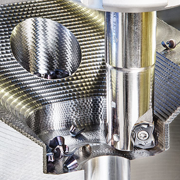

LOGIQ-4-FEED Twisted Shape Insert for Efficient High Feed Milling
LOGIQ-4-FEED, a family of indexable cutters for rough machining and high feed milling. These cutters feature narrow "bone-shaped" double-sided inserts with four cutting edges.
LOGIQ-4-FEED was originally designed for roughing operations, particularly when machining deep cavities mainly in the die and mold and aerospace industries. Later, LOGIQ-4-FEED expanded its application range to other industrial sectors.
Each "bone- shaped" insert has a minor cutting edge for improved cutting action in ramp-down milling.
These inserts have 4 types of cutting geometries for machining different materials under diverse cutting conditions:
T - Steel, ferritic and martensitic stainless steel, cast iron and hardened steel
HP - Austenitic stainless steel and high temperature alloys
RM-T - Interrupted cut for machining near straight wall shoulders of steel, ferritic and martensitic stainless steel, cast iron, and hardened steel
RM-HP - Interrupted cut for machining near straight wall shoulders of austenitic stainless steel and high temperature alloys
Features:
  • Available in two subfamilies: for mounting inserts of 04 mm and 08 mm sizes
  • 17° cutting edge angle.
  • Progressive cutting geometry reduces cutting forces for smooth cutting.
  • Ramping down capability.
  • Protective coating on cutter body for uninterrupted chip flow and protection against corrosion and wear.
  • Internal coolant holes directed to each cutting edge.
