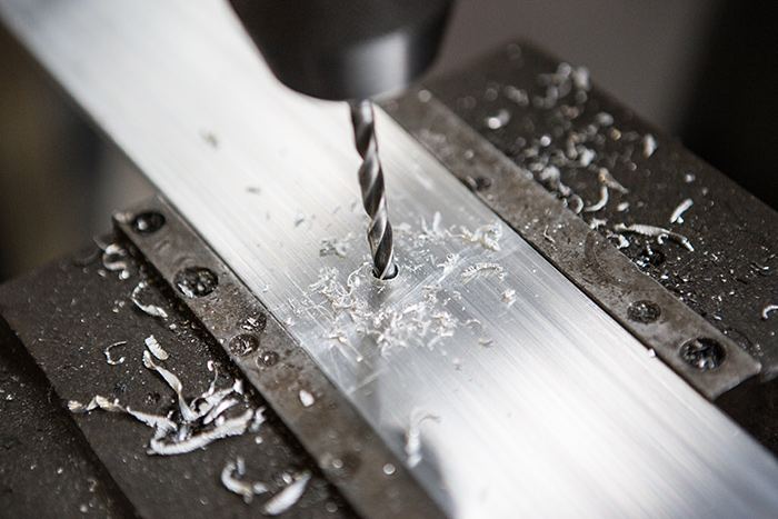

“Chips tend to ‘string out’ because of the softness of the material,” Lynch explained. “The primary way to get around that is through geometry.” AMEC offers an aluminum-specific geometry for its TA product line, which has a high rake angle that effectively forms a chip in gummier, 6061-type materials, he said. A higher rake creates more shear in the cut and forces the material into the impact site on the tool.
The main difference between drilling aluminum and harder materials, noted Jason Hout, global DHM (deep hole machining) product and application specialist for Sandvik Coromant Co., Fair Lawn, N.J., is that the shear point of aluminum is low enough that it can be sliced by the tool’s cutting edge, as opposed to being pushed out
of the way when machining harder materials. This means an upright, high shear angle with a minimal edge hone is ideal for drilling aluminum.
“Generally, drills with a high helix angle, polished flutes and 130° to 140° point angle will provide the best chip evacuation and cutting performance,” Frazier said. “However, since aluminum is so soft, drilling operations using the aforementioned geometry tend to present difficulties in maintaining proper hole diameter and sidewall surface finish. If maintaining hole size, finish and hole roundness are the goals, using a straight-flute, through-coolant drill is advantageous.”

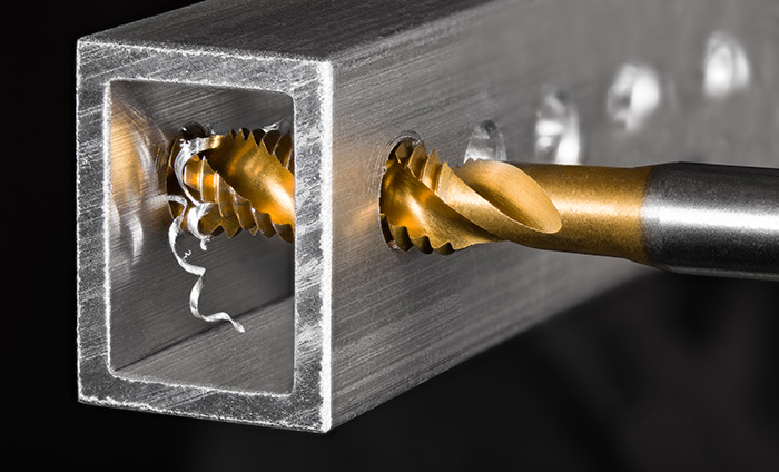

When applying a carbide tool, it’s important that it doesn’t have an aluminum-based coating, because the aluminum will tend to stick to the workpiece surface, he added. Common coatings such as Al2O3 or AlTiN, when brought into contact with aluminum under heat and pressure, will not only react with the part, but have abrasive properties that can contribute to BUE. Instead, Hout recommends either titanium diboride or an amorphous diamond film.
If those aren’t available, uncoated carbide with a polished surface provides more-than-adequate performance in most applications, Hout noted. “You want the flutes polished to help material slide out, and if there is a radius within the flute, you don’t want a square edge or a straight wall unless it’s unavoidable [such as when gundrilling].”
Frazier recommends a micrograin carbide with a hardness from 92 to 93 HRA for low-silicon alloys, but said some aluminum alloys used for forgings or castings contain more than 11 percent silicon and are best approached with drills tipped with PCD or diamond-like carbon.
“Usually, coatings are not applied to drills in aluminum applications, as a majority of coatings contain aluminum,” he said. Because the majority of coatings contain aluminum as one of their base constituent elements, Frazier said some manufacturers have begun utilizing a titanium-zirconium-nitride coating in aluminum applications. “But the conventional wisdom in this field is to utilize a sharp, high-polished, uncoated carbide drill.”

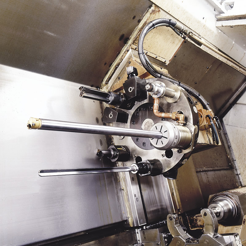

Sandvik Coromant’s Hout has observed at least one characteristic unique to aluminum when deep-hole drilling. “When using self-guided drills like gundrills, because of the plasticity of aluminum, the guide path pressure can impact the finish of the hole either positively or negatively, depending on the lubricity of the coolant,” he said. Neat cutting oil typically results in a smooth finish, while a synthetic, water-based fluid might allow some of the aluminum to stick to the guide path, creating a rough, “smeared” finish.
Running at high cutting speeds while resisting the temptation to overfeed and applying a coolant with high lubricity and moderate-to-low viscosity is the best way to ensure a fine surface finish, Hout said. “You want the oil to move fast.”

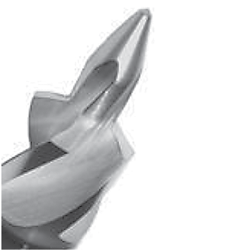

Flowdrill’s Aludrill geometry is specially designed for use in aluminum. Image courtesy Flowdrill.
Every tool bit diameter has a certain set of parameters, Ray explained. For example, a ¼-20 thread size would require a tool to be run at 2,400 rpm in aluminum or mild steel, require 1.5 hp and have a cycle time of about 3 seconds per hole. The bit contacts the material, and the friction of that contact heats the material while the pressure behind the bit pushes through the material and forms the bushing. There is no external heat source, and Flowdrill bits can be used on any standard CNC machine without any special adapters. For a deeper look at Tips and Tricks for Threading Aluminum Parts, see this supporting resource.
The company’s newest geometry is called the Aludrill, which is designed specifically for aluminum.
Thermal-friction drilling creates a hole and a bushing—but no chips—through the use of heat and pressure. Image courtesy Flowdrill.
“Unlike our other bits, it doesn’t require our special lubricant; it can operate with standard machine coolant,” Ray said. “It also countersinks a chamfer into the material, which makes it the only one of our bits that generates a chip.”
On a standard Flowdrill bit, a polygon is ground, consisting of four peaks and four valleys, each referred to as “lobes,” which are what generate the friction and cause the heat. The Aludrill eschews this geometry in favor of more contact with the metal, which creates enough friction in the softer aluminum to generate sufficient heat.
