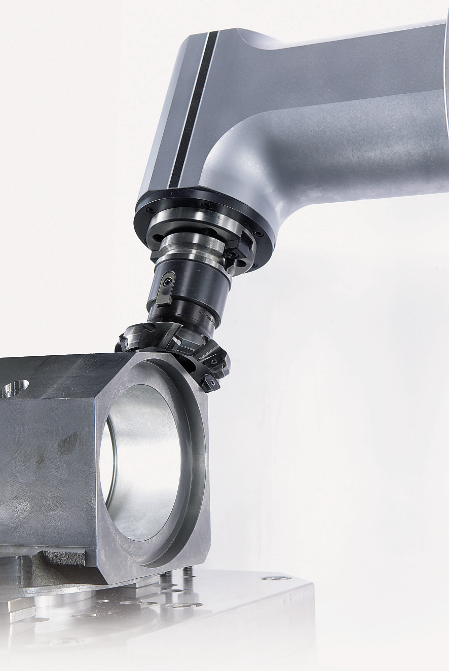

Faced with machining a feature without the ability to position the part so the feature can be reached and not wanting to refixture the part to perform another operation, where do you turn? To an angle head supplier.
"Sometimes there also are constraints based on part geometry or fixturing where you need an angle head to get into an area to do the machining, such as inside a bore," said Mark Johnson, general manager of OMG North America, Post Falls, Idaho, a provider of multispindle heads, angle heads, turret heads and spindle speeders. "There might be features inside of the bore that you can only access by going inside with an angle head."

The applications for angle heads include milling, drilling and tapping, and while part manufacturers most frequently use them on 3-axis vertical machining centers, angle heads can also be found on machine tools with five or more axes.

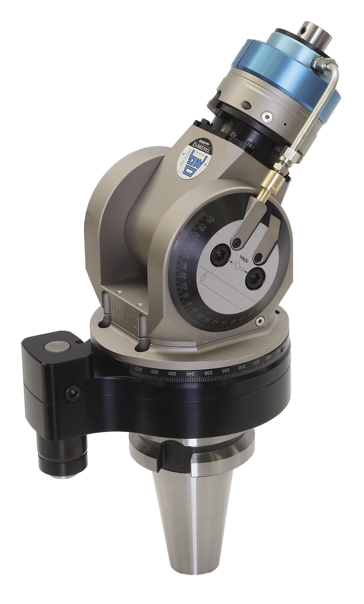

The output of this AGU90 geared angle head from BIG Kaiser can be adjusted in 1° increments, while the entire base is adjustable 360° to provide any compound angle. Image courtesy BIG Kaiser Precision Tooling.

In addition to fixed-angle heads, which are usually at a right angle, BIG Kaiser, like others, offers standard universal angle heads that are infinitely adjustable from 0° to 90°. "The angle heads can be positioned in any degree radially," Miller said, "so you can make whatever compound angle you need."

He added that an angle head with a CV joint is about 25 percent lighter and costs about 15 percent less than a comparable geared angle head. It's available on an adjustable series of heads, but instead of being able to go from 0° to 90°, it will only swing from 0° to 30°. "That's due to the limitations of that CV joint," Miller said.
However, most angled applications fall into the 0° to 30° range, according to Miller. "Fully adjustable from 0° to 90° at any degree is a little more specialized."
Facemilling is one application for which angle heads are suitable. Image courtesy Koma Precision.

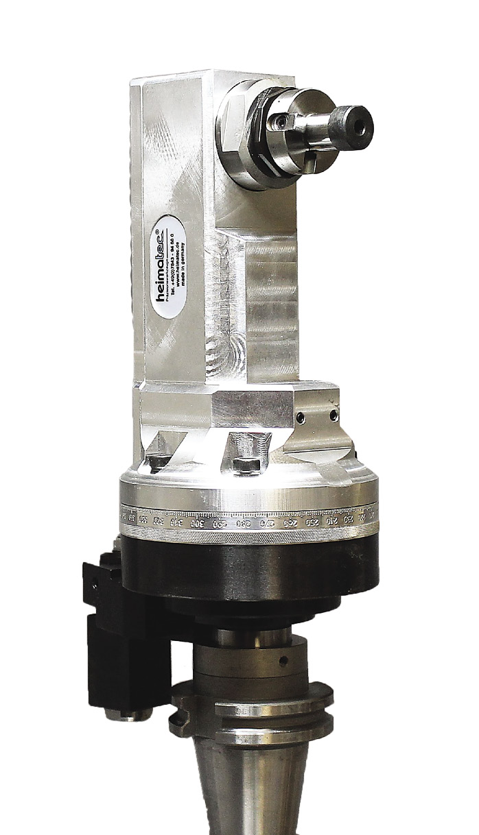

When a parts manufacturer purchases a right-angle head, it's usually not for a dedicated production operation. To allow a standard ER-output live tool to accept various adapters for different applications, Heimatec Inc. offers the U-tec flexible adapter system on its right-angle heads. This lets users quickly changeover tools on almost any lathe or mill, using a single live tool, without having to commit to a quick-change system on the initial purchase.
Heimatec offers the U-tec flexible adapter system for all major
turning machines on the market. Image courtesy Heimatec.
"Customers often want to do different things when they invest in an expensive tool like that," said Heimatec's Preben Hansen, "so we have a changing system built into it."
This enables a user to take the ER collet out and put in, for example, a side-lock holder, an extension or a facemill, shell mill or endmill adapter, without the need to install a completely new base. "You can even do a drilling and tapping application with the same tool," Hansen added. "You stop the program and change the insert instead of buying two angle heads."
He noted the adapter system is especially beneficial to users doing deep-hole drilling with extended tools because of its rigidity and quick-change capabilities.
