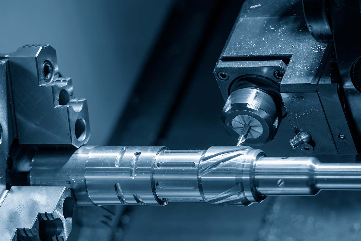

So what is a multitask machine? The answer depends on the person who is asked. In general, it is a single machine capable of performing multiple types of machining operations like milling and turning. The machines are computer-controlled and hold a plethora of cutting tools. It is also common to see the machines fitted with bar feeders or other automatic loading devices. The goal is to load a piece of stock and remove a finished part, eliminating the need to use other machine tools.

Several advantages come with completely machining a part in one machine, and the most significant is the reduced cost of labor. Old-school methods would move the part from machine to machine until it was complete. A shaft is a good example. First, someone would use a saw to cut a blank from a bar. The blank would be taken to a lathe, where the blank would be turned. After turning, the shaft would go to a milling machine to have holes or keyways cut. Finally, the shaft might go to a grinder, where the bearing journals would be ground.
Each of these operations requires a setup, which introduces more cost. But all these operations can be completed in a modern multitask machine, thereby eliminating all the extra setup time. Add automation, such as a bar feeder or robot, and the machine could produce completed parts unattended.
Completing a part in one setup also enhances precision and accuracy. When a part is processed across multiple machine tools, it is easy to introduce errors. As the part is moved from machine to machine, a new setup is required, and any error in that setup is transferred to the part geometry. Parts completed in a multitask machine are not subject to errors from multiple setups. In some cases, geometric tolerances are so stringent that a multifunctional machine is necessary, not a choice.
