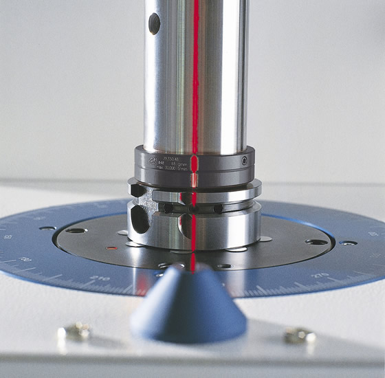

Courtesy of Haimer USA
A laser guides the position of balancing rings on a toolholder to displace weight and correct unbalance on a Haimer TD-2009 balancing machine.

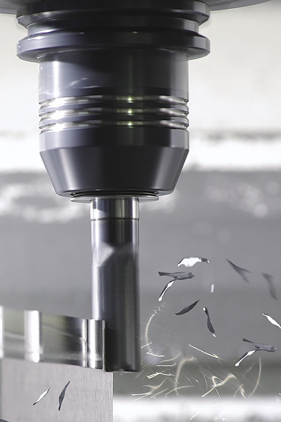

Courtesy of Schunk
A corner-rounding operation on an aluminum workpiece using a balanced Tendo toolholder from Schunk.

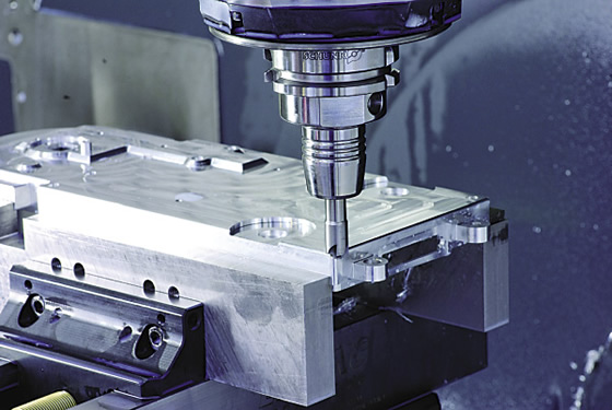

Courtesy of Schunk
High-speed milling aluminum with a Tendo E compact hydraulic workholder from Schunk.

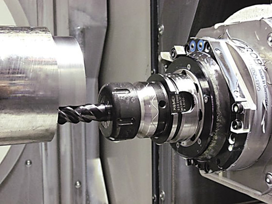

A Haimer balanceable power collet chuck prepares to take an aggressive cut.

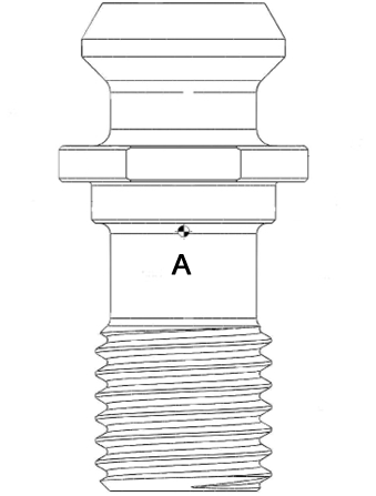

Andrew Rowley, president of JM Performance Products Inc., Fairport Harbor, Ohio, said this is commonly overlooked. “People assume the pull studs are balanced, but in reality most of them aren’t even close. For this reason, it’s important to use a high-quality retention knob and always include it as part of your balanced assembly.”
Courtesy of JM Performance Products
A thread relief (area A) eliminates expansion at the small end of a tapered toolholder, assuring a proper fit and reducing vibration.
