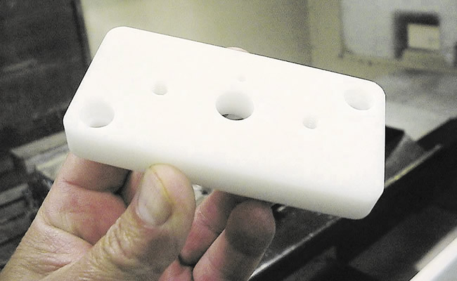

This adapter plate is a simple part, but once you can make one using a CAD/CAM system, you'll have a good foundation for producing more complex parts. Image courtesy J. Harvey.
