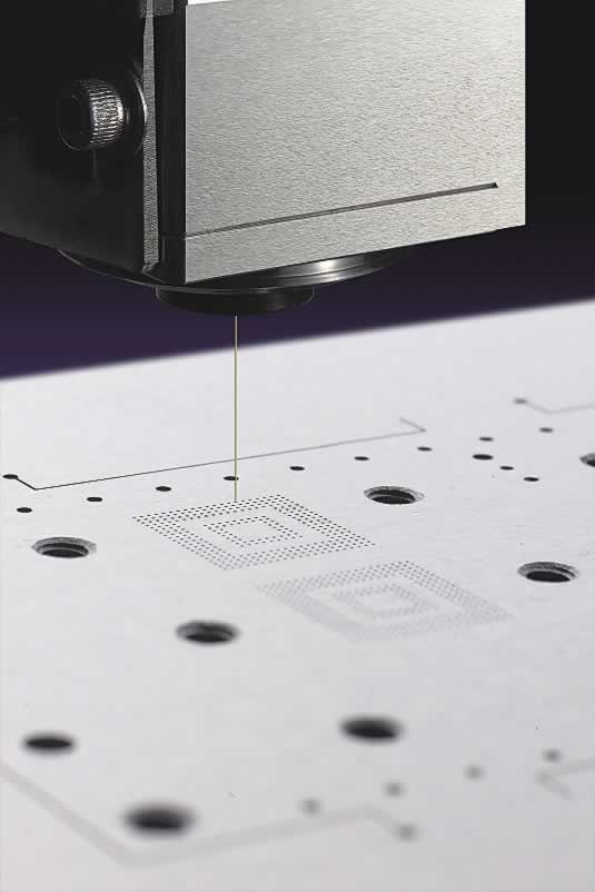

Automatic wire threading through even the smallest of holes is possible. Image courtesy Sodick.
Most EDM wire is brass and has a diameter ranging from 0.004" to 0.012" (0.102mm to 0.305mm). It’s wrapped on a lunchbox-sized plastic spool and is anywhere from a few thousand yards to dozens of miles long. The challenge when threading wire is that it “remembers” it was once curled around a spool, a memory that causes it to go everywhere but where it needs to go: straight down, into the lower guide.

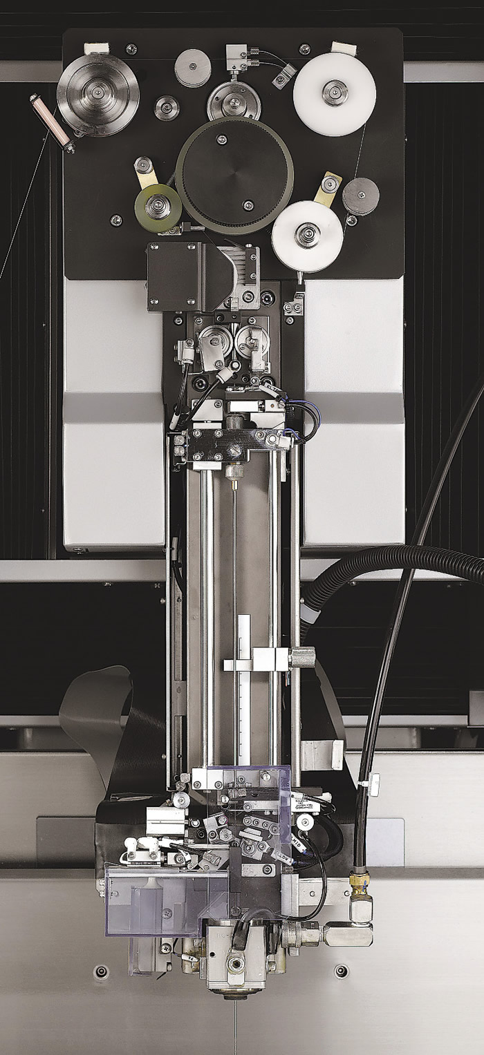

At top is the tortuous path a wire must take through an EDM. Below is Sodick’s formerly used tube mechanism for threading water-dielectric EDMs. Image courtesy Sodick.
“Today, we use an annealer and waterjet-assist, a method similar to what every machine builder in the industry is using,” Meyer said. An industry-standard method of wire threading, it involves application of a pressurized jet of water—approximately 30 psi (2.07 bar)—to direct the wire from the upper guide to the lower. The method requires that the wire be straight, something that’s accomplished by annealing a length of wire at least equal to the distance it must traverse. For EDMs with large Z-axis travels, this means annealing the wire for 18" (457.2mm) or more.

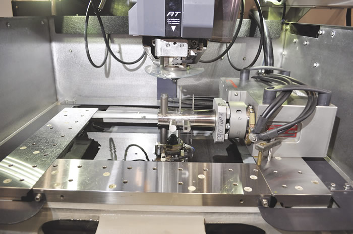

Mitsubishi offers such a long-travel machine. Mike Bystrek, national EDM product manager for MC Machinery Systems Inc., Wood Dale, Ill., a subsidiary of Mitsubishi Corp., said annealed lengths of up to 27" (685.8mm) are possible on some Mitsubishi models, with wire straight enough that a waterjet is often unnecessary. “Because of the annealing process, we don’t have to go back to the start hole when the wire breaks. We can thread it through the workpiece from the point where the wire broke by using the kerf to guide the wire.”

Mitsubishi’s AT intelligent automatic threader reduces wire curl and rethreads through the gap if the wire breaks. Image courtesy MC Machinery Systems.

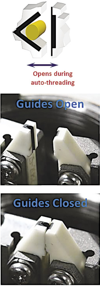

The type of wire guide also plays an important part of AWT success. Round, PCD guides with a hole just a few tenths of an inch larger than the wire diameter are the most common. Several EDM builders offer round-guide machines, as well as ones with “split,” or open, guide systems. These have a V-shaped mechanism that cradles the wire from all sides, which, according to Brian Pfluger, EDM product line manager at Makino Inc., Mason, Ohio, offer greater contact area, easier threading and better guide life than round guides. “The beauty of split-guide systems is reliability. I can even have a small kink in the wire and it won’t affect anything. It’s like threading through a barn door.”
Because of this barn-door effect, split “V” guide systems often incorporate a mechanical scissors device to cut the wire, which can leave a slight burr on the wire tip. This is not a problem with a split guide’s wide opening, but will cause interference if used with a round guide. “The key driving factor with AWT performance is the end-user’s application,” Pfluger said. “Each wire guide system and AWT design have unique pros and cons, and each user should clearly identify and understand their own unique requirements.”

Wire kinks and scissor burrs are not a concern with split guides, which open during automatic threading. Image courtesy Makino.
