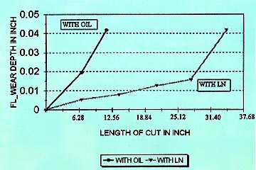

Figure 5 shows the results of turning Ti-6Al-4V with an H-13A cemented carbide insert at the following parameters: speed, 840 rpm; feed, 0.008 ipr; DOC, 0.0195"; rake angle, g0=0°; inclination angle, ls=0°; clearance angle, a0=7°; and nose radius, 0.31". Each point in the graph corresponds to the wear measurement after each cut. Cuts ranged from 5" to 8 1/2" in circumferential length. When machining was done with oil coolant, the tool wear measured 0.042" after machining a circumferential length of 11.47".
When machining was performed at the same parameters using liquid-nitrogen coolant, the tool wear was only 0.008" after machining a circumferential length of 13.85", that is, one full cut plus 2.38" of another cut. With liquid-nitrogen coolant, the tool could machine a circumferential length of 34.42" before exhibiting as much wear as an oil-cooled tool did after only one full 11.47" cut.
It appears that lowering the temperature of the insert reduced tool wear when machining Ti-6Al-4V or RBSN. When machining Ti-6Al-4V, the lower temperature reduced chemical reactivity between the work material and the tool. For both work materials, the lower temperature prevented softening of the insert material.

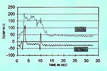

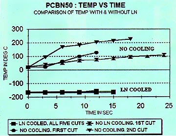

But to what extent does liquid nitrogen really lower cutting temperatures? Our experiments revealed that the cryogenic cooling system dramatically reduced the temperature of the cutting insert during the cutting process. The temperatures measured using a thermocouple at 0.079" from the PCBN 50 tool’s edge in machining both RBSN and Ti-6Al-4V with oil and liquid nitrogen are shown in Figures 6 and 7.
Figure 6 shows the cutting temperature for the tool that cut RBSN using liquid nitrogen for five cuts totaling 160mm in circumferential length, a tool run without liquid nitrogen for one 40mm-long cut, and another tool run without liquid nitrogen for two cuts totaling 40mm in length.
Tool temperature increased with the cutting time when liquid-nitrogen coolant was not used. When the tool was used for a second cut, the temperature increased at a much higher rate than in the first cut because of the increased tool wear. When the turning process was subjected to liquid-nitrogen coolant, the measured temperature (-160° to -170° C) remained almost constant. Without liquid-nitrogen coolant, PCBN 50 tools didn’t last long enough to be practical for the turning of RBSN.
Figure 7 depicts cutting temperatures measured in the machining of Ti-6Al-4V. A maximum of about 210° C was measured when oil coolant was used, as opposed to a peak value of 120° C with liquid-nitrogen coolant. It should be noted that a red-hot chip formed during machining contacted the thermocouple wire (not the junction), and this may have affected the readings. There are two peaks, one close to the 3-second mark and the other close to the 10-second mark. Peaks occurred in the same region for both liquid-nitrogen- and oil-cooled machining. This was caused by the workpiece’s surface profile. The hardness of the workpiece on both ends of the cut is slightly higher than the hardness in the middle part of the workpiece. That’s because the workpiece’s profile causes the temperature to drop much faster on either end than it does in the middle. The same trend can be seen in the force measurements.
