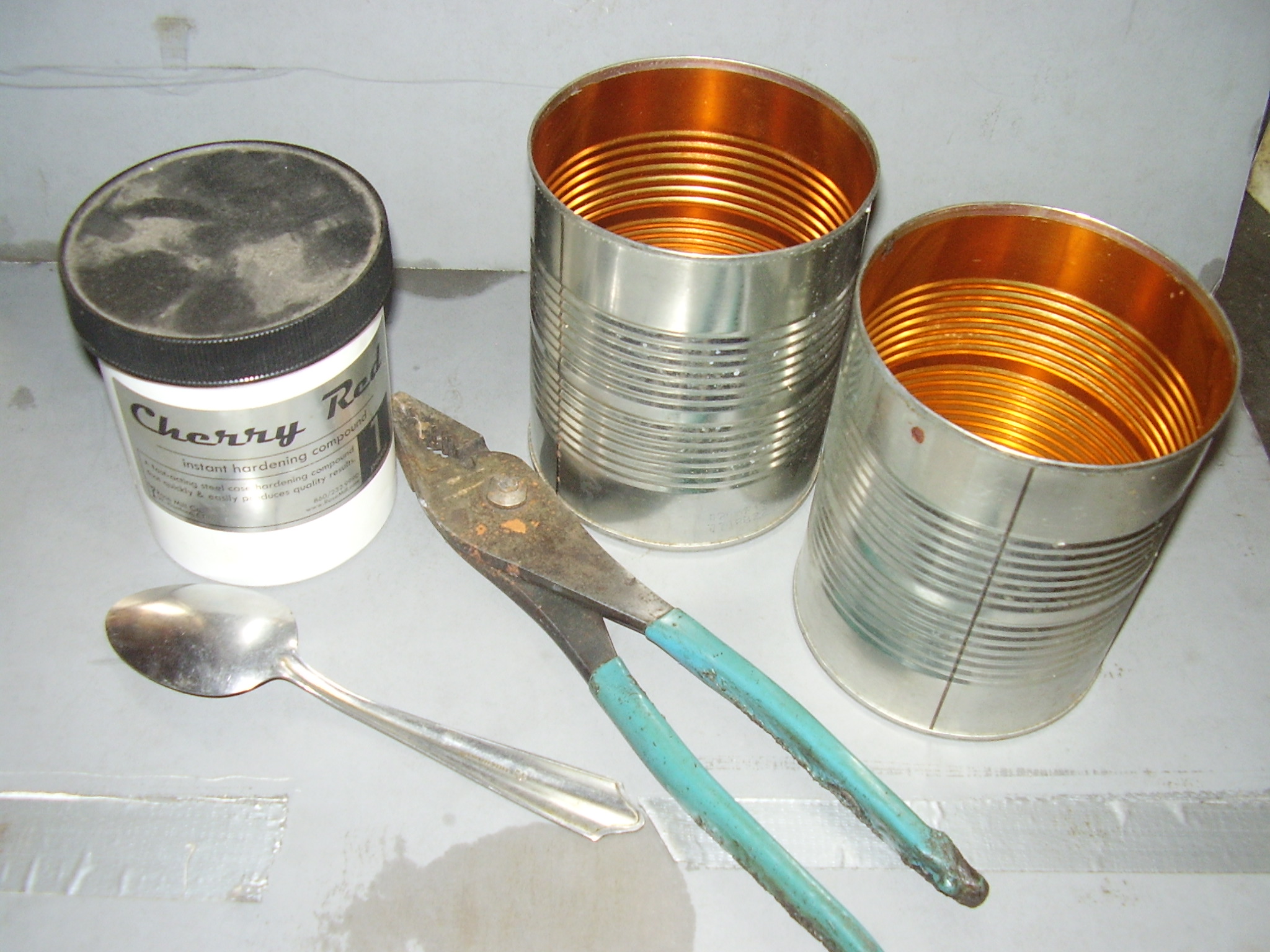

You don’t need much to get started. Image courtesy of B. Taylor
The process is simple.
1. Heat the area to be heat-treated to a cherry red color.
2. Coat the red area with the heat-treating compound. When I do the end of a punch, I put some compound in a tin can and plunge the tool in. Use a well-ventilated area or, better yet, do it outdoors because it gives off ammonia fumes when the compound is heated. Cherry Red comes in a plastic container, so don’t put hot metal in the container. And take care because the compound can irritate skin.

3. Reheat the area to be hardened to the cherry red color.
4. Quench the part in water or oil, and let cool.
5. Soak the part in water to remove the compound from the part.
The process causes a layer of the compound to become stuck on the steel, but it is water-soluble and so not too hard to remove. The compound dissolved in water is alkali and can irritate skin, so it’s a good idea to use rubber gloves and flush with plenty of water.
The picture on Page 10 shows what is needed: a container of Cherry Red; two tin cans — one to hold the compound and one for the quench; pliers to grab your part; and a spoon to coat the part if that’s appropriate. You also need an acetylene torch. Plan your process beforehand, and check to see that everything will work smoothly. You want the part to be bright red when coated by the hardening compound. You’ll be dealing with hot stuff, so having a plan is worthwhile.
