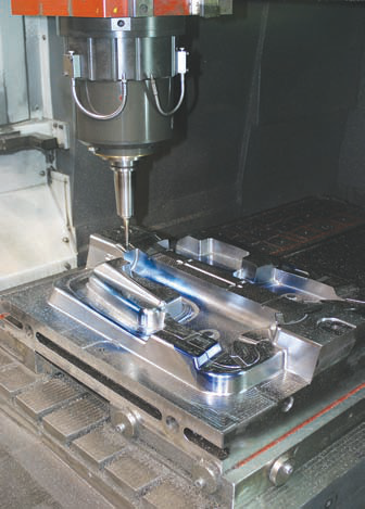

Molds are high-value items, usually produced in single-digit volumes, and machining mold tooling typically involves creating complex contours and fine surface finishes.
To overcome the volatility of the manufacturing market, Die Technology maximizes productivity by providing its employees with advanced technology that enables the company to do more with fewer people, according to Wyatt Neubauer, toolmaker. A key element of that effort is ESPRIT CAM software from DP Technology Corp., Camarillo, Calif., an integrated 3-D system.
Neubauer considers the 3-D aspect of toolmaking to be its major challenge. For example, the shop makes pins as small as 0.003 " in diameter with 0.003 " or 0.002 " profiles on top of them. “Everything has to be formed in 3-D, all the contours,” he said. “With a 2-D CAM system, we couldn’t produce the shapes and functionality we needed with any kind of speed; 3-D CAM enables us to make it all without using special-order tools.”

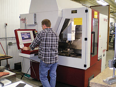

At Vaupell, high-tech metal-removal equipment includes Röders high-speed CNC machining centers. With Cimatron CAD/CAM software on the shop floor, operators can determine part dimensions and machine directly from the 3-D model.

Cost reduction includes “as much unattended machining as possible,” he said. Metal-removal equipment at the shop includes Röders high-speed CNC machining centers, Charmilles CNC sinker EDMs and Agie wire EDMs.

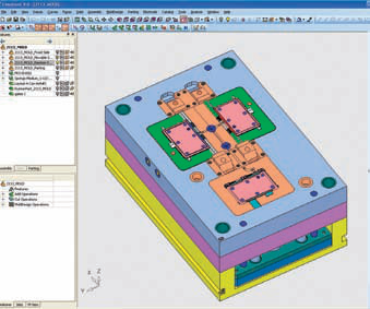

Advanced manufacturing software is another tool for enhancing competitiveness. In 2006, facility management decided to switch from 2-D manufacturing software to 3-D. Eric Wagner, senior design engineer, said a desire to streamline the mold production process prompted the change. “All of our CNCs are driven off 3-D models. We were having to do things twice. We’d design a whole tool, detail it in 2-D, then I’d have to take it and model it in 3-D to be able to program the machine.” Use of integrated 3-D CAD/CAM software eliminated the double work; the molds are designed in 3-D and toolpaths are applied directly to the model.
The designers who would use the software researched several products and recommended Cimatron E CAD/CAM software from Cimatron Ltd., Novi, Mich. An important factor in the choice was Cimatron’s knowledge base in moldmaking, according to Wagner. “They understood injection molds, and their support people have designed injection molds and done the kind of work that we do,” he said.
Courtesy of DP Technology/ESPRIT
In addition to conventional machining processes, sinker EDM and wire EDM (pictured) are key elements of die and mold manufacturing. CAM software, such as ESPRIT, can simplify a shop’s work flow by handling all of a facility’s metal-removal operations.
Cimatron software, the use of which was expanded throughout the shop in 2009, features full associativity throughout the design and machining processes. Prior to the changeover, the facility employed six different software packages in the toolroom and design areas, creating the potential for translation errors and making engineering updates difficult. “Now, if one of my guys makes a change on an already-programmed part, I can go in, pull up the part and update it, and all I have to do is re-recognize things and then I’m flying again,” Wagner said. “Prior to that, if there was a change I would have to bring in the model and do all the work again.”

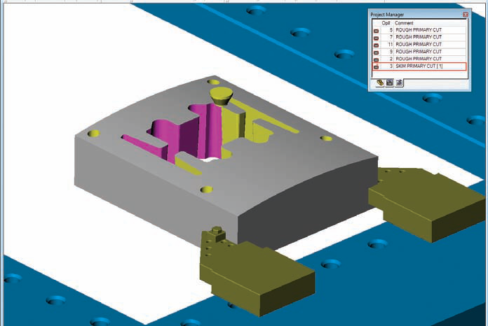

Courtesy of CGTech

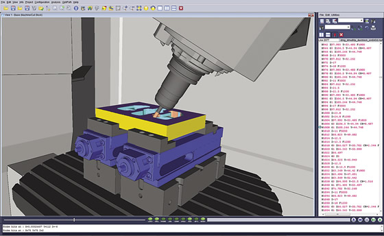

Premachining simulation of CNC cutter paths, as illustrated by VERICUT software, enables a user to virtually machine parts on a computer screen before actual cutting occurs. Such verification can be of crucial importance in the short-lead time, single-digit-production environment of moldmaking.
Virtual verification makes mold mistakes disappear

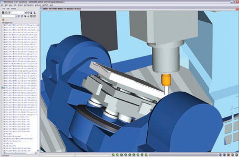

Just as the “reset” button erases mistakes in a video game program and starts the game anew, so does NC verification software by eliminating programming errors—and their much more costly results—in machining.
CGTech Inc., Irvine, Calif., maker of VERICUT CNC simulation and verification software, says simulation enables a user to virtually machine parts on a computer before cutting, and detect and eliminate errors that could ruin the part, damage the fixture, break the cutting tool or crash the machine. Such verification can be crucial in the short-lead time, single-digit-production environment of moldmaking. Starting over after a crash or gouge of a high-value mold is not only expensive, but missed deadlines and poor surface finishes will sour a shop’s relationship with its customer.
Unlike the verification feature built into many CAM packages that check the internal CAM file before post-processing, VERICUT’s external simulation verifies the post-processed NC code as sent to the machine tool, according to CGTech. Also, a program optimization module, OptiPath, creates toolpaths that maintain consistent chip load and cutting pressure, benefiting surface finish and reducing bench work finishing for moldmakers.
Development of the OptiPath module was largely driven by the mold and die industry. It reduces the long machining times common with large, complex dies and molds. OptiPath retains knowledge of the amount of material removed and the amount remaining, and thereby can determine ideal feed rates, slowing feed during heavy material removal and increasing the rate when cuts are lighter.
