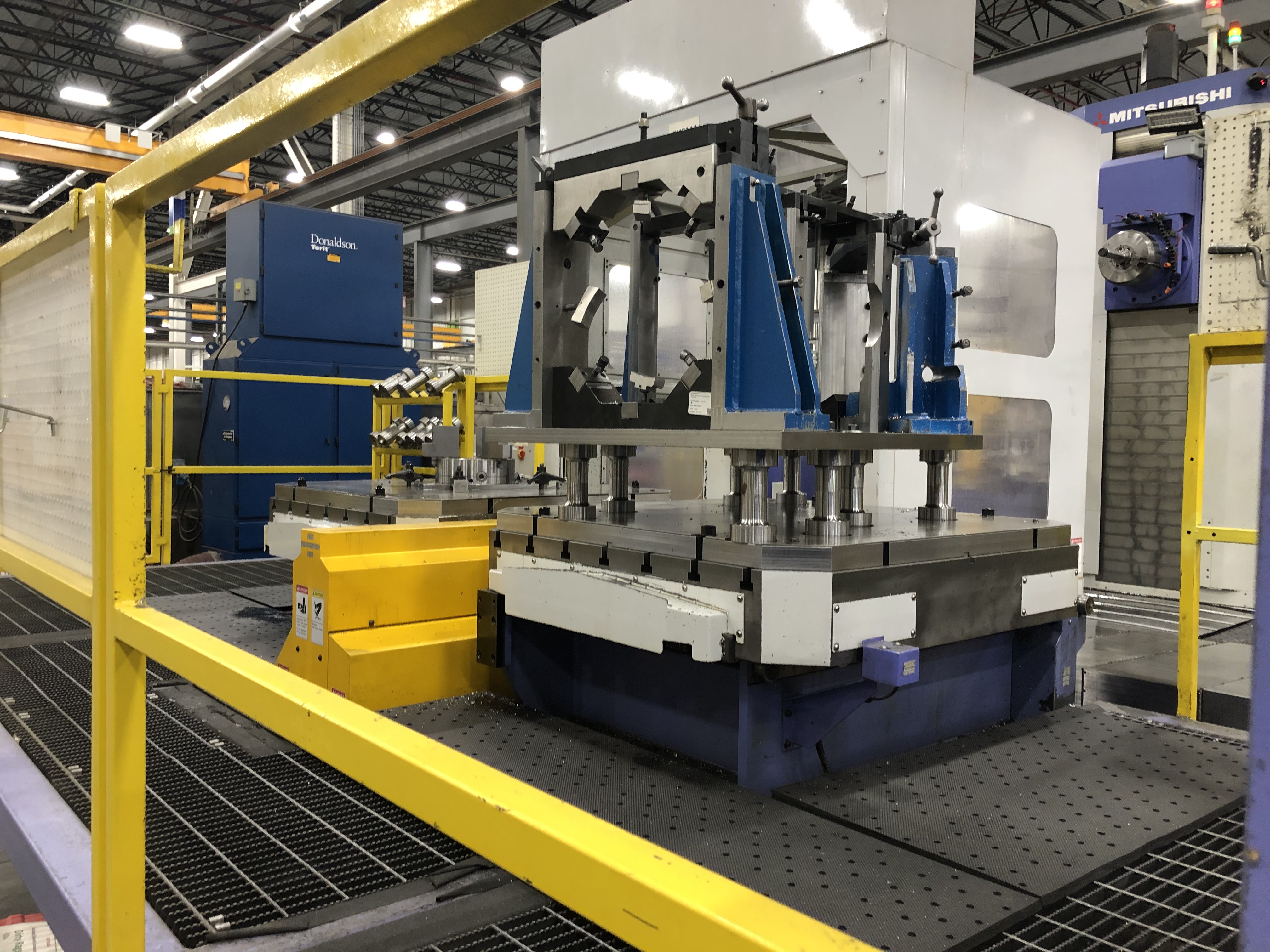

Mitsubishi Hitachi Power Systems Americas specified pallet changers for its horizontal boring mills and recovered the added expense during the first year that the machines were in operation. Image courtesy of C. Tate
Adding pallets to a machine also can reduce noncutting time by allowing setup and changeover to occur while the machine operates. At Mitsubishi Hitachi Power Systems Americas Inc., we machine our combustion hardware after fabrication. These parts are difficult to hold; sometimes it can take over an hour to clamp and align a part. Machining cycles are lengthy, and completing one part can take longer than a shift. By purchasing machines with dual pallets, we are able to take advantage of long run times and complete setup activities on one pallet while the other pallet of workpieces is in the machine being cut. While we have not eliminated setup — yet — we have eliminated its cost.
