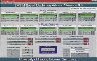

Figure 2: The Machining Advisor software testbed will allow users to determine optimal cutting conditions for a process based on the results required.
This is where UIUC’s EMSIM-based Machining Advisor software steps in. It allows users to optimize the machining process by offering a range of cutting conditions for a given set of performance standards (Figure 2). An endmilling model has already been developed and was made available to the program’s sponsors in May. Plans call for it be offered to the public in 2000. Additionally, a system for facemilling, based on FMSIM, is under development.
“I think some of our industrial sponsors will use [Machining Advisor] to try to fine-tune their processes,” said DeVor. “They want to squeeze some money out of their process by saying, ‘How hard can I push this cutting tool? How aggressive can I be and still meet the quality requirements?'”
All input variables are specified as search variables or fixed variables. For search variables, the user inputs the lowest and highest value allowed for each variable. Fixed variables require the input of specific values. The software also has a sensitivity-analysis feature, which allows the user to see which variables have a stronger effect on the process.
Once the variables are input, Machining Advisor conducts a series of virtual test runs and pinpoints the variables that produce the results closest to the specified requirements.
