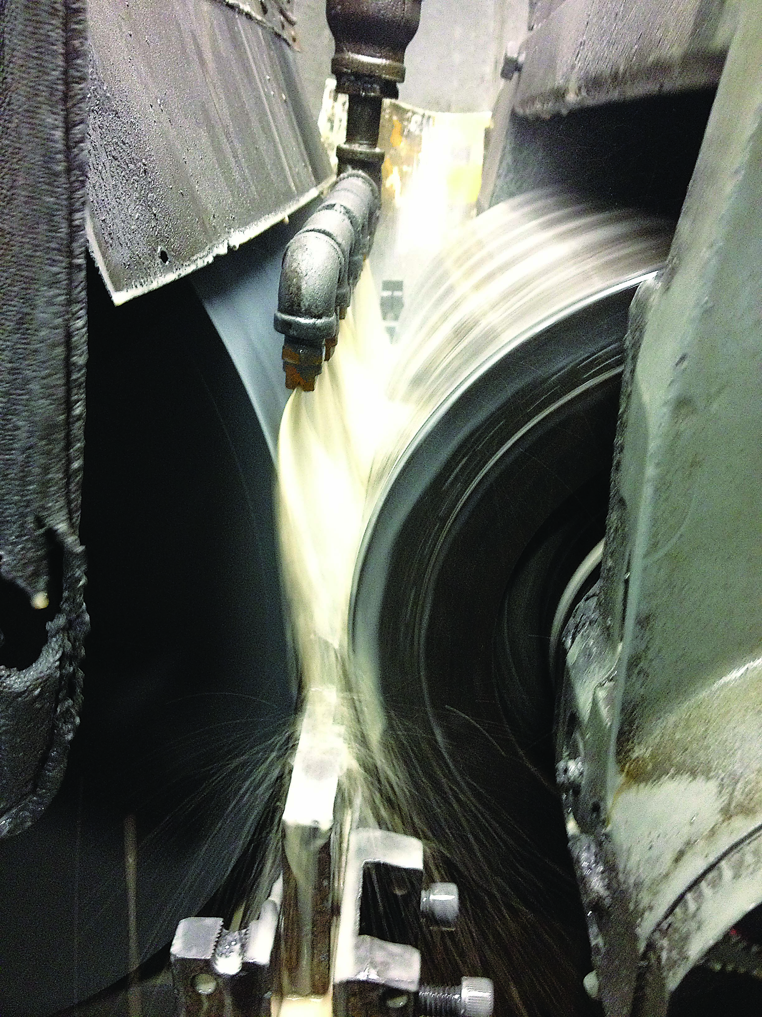

Because grinding wheels reach far higher peripheral speeds than cutting tools, wheels have a more pronounced boundary layer of air surrounding them during operation. This air barrier can deflect coolant from the grinding zone unless the pump pressure is sufficient for the coolant jet from the nozzle to match the wheel speed and penetrate the barrier.
All images courtesy of Cool-Grind Technologies.
The photo (above) shows a centerless grinding process with a 10-psi (0.7-bar) coolant stream applied through a row of fan nozzles. The jets are aimed slightly toward the 6,000-sfm (1,829-m/min.) grinding wheel on the left side. The photo shows the air barrier deflecting the coolant toward the regulating wheel on the right side, with no coolant hugging the wheel and entering the grinding zone below.
In centerless grinding, the air barrier creates the additional problem of lost friction between the regulating wheel and the workpiece. Lost friction leads to slippage between the regulating wheel and part and more frequent wheel truing to restore the worn drive surface. In all forms of grinding, wetting the wheel will allow the extreme-pressure additives in the coolant to do their job. The additives will keep forces and wheel wear low, create a cleaner wheel structure, reduce the amount of wheel dressing and allow more aggressive feed rates.

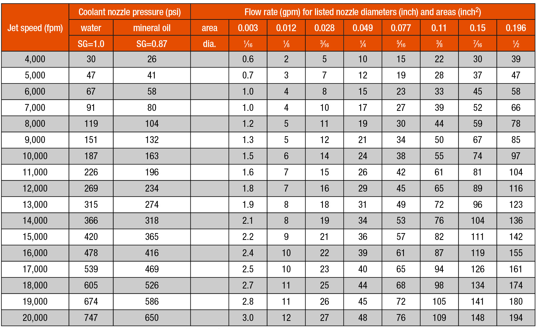

Bernoulli’s energy equation can be used to predict the pressure that creates the desired jet velocity. For example, a grinding wheel moving at 12,000 sfm (3,657 m/min.) requires a nozzle pressure close to 270 psi (18.6 bar) for the coolant jet to match the wheel speed. Lower wheel speeds require lower pressures. The chart (below) shows the pressure required for water-based, synthetic oil and mineral oil coolants to achieve the desired jet speed.
English flow-rate chart for a nozzle with a 0.95 coefficient of discharge.
