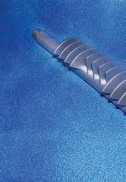

One challenging machine part was a cylindrical component used to separate small plastic parts after ejection from an automated molding machine. The 9 "-long, 303 stainless steel part has a dozen 0.6 "-tall × 0.060 "-thick radial fins that extend about a quarter of the way around the circumference of its 5⁄8 "-dia. shaft. In use, a computerized control rotates the shaft back and forth to selectively stop and release parts as they move beneath it.

When OMW machined this 9 "-long component for an automated manufacturing system from 303 stainless steel, the shop overcame challenges that included finding a way to quiet a dozen 0.060 "-thick fins that “rang like a bell” during a milling process.

Cutting the excess flute material from the shaft, however, was “a tricky thing,” Osborn said. The fins were “too thin, only 0.060 " wide. When you cut them away, they rang like a bell. That created chatter and terrible surface finish.” In addition, when the fins began to vibrate, the endmill often would catch on a fin and bend it. Osborn called the initial fin-cutting efforts “a disaster.”
The shop’s creative but simple cure for the ringing fins was aluminum spacers, about 0.3 " wide × 0.75 " tall × 0.5 " long, pushed between the fins. The spacers were “kind of jammed in there and they wanted to fall out,” Osborn said, so they were attached one to another with a thin band of aluminum. “They stuck up about 1⁄8 ", but that didn’t matter because we weren’t machining exactly where they were. They were there to keep the fins from vibrating, to make the machining possible.”
The fix worked; a 4-flute, 3⁄8 "-dia., coated, solid-carbide bull nose endmill with a 0.0156 " corner radius removed the excess fin material at 4,000 rpm and 20 ipm.
In addition to removing about three-quarters of each fin from around the shaft, Osborn said: “We had to go back and machine the last part of each fin away, perfectly matching the contour of the bar. It almost had to look like the fins were welded onto the bar. All we were allowed to leave was the bar’s round shape.”
