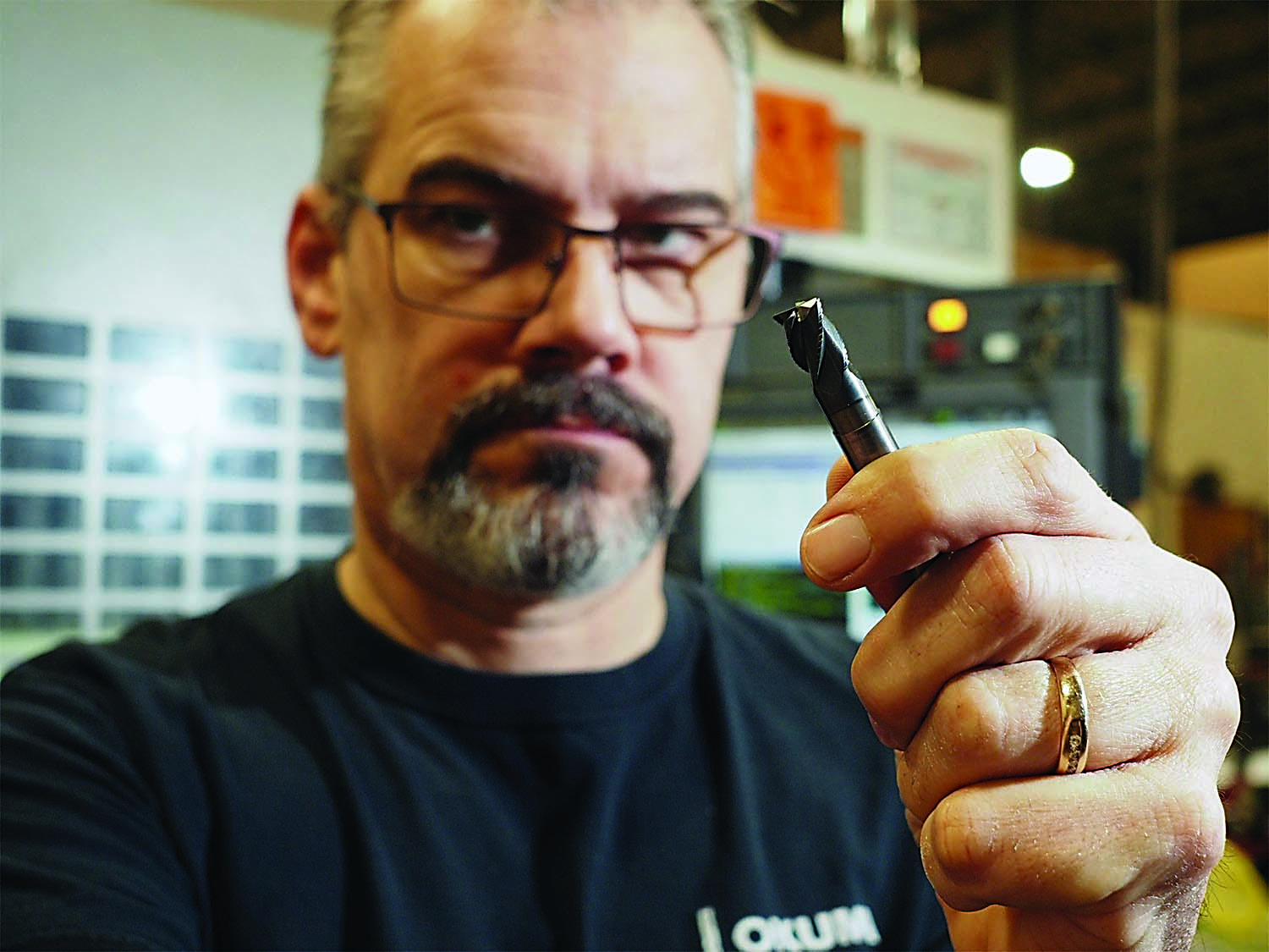

With an eye toward continuous improvement, Tommy Coulter, CNC programmer and tool and die maker at MW Components - Columbus, likes to test cutting tools from time to time. Image courtesy of MW Components - Columbus

"Emuge asked me what I was looking for in a cutting tool, and I explained that side loading was a huge issue," Coulter said. "I was using a trochoidal milling technique with a high-quality, extended-length cutter, but it wasn't enough. We needed an endmill that would minimize cutting forces as much as possible. This would eliminate the flexing and hopefully improve tool life."
Evan Duncanson, milling application specialist at Emuge-Franken, went to work with his team and engineered and manufactured a special.
"We basically combined two of our standard tool geometries into one," he said. "Our intent was to replicate what the customer was using but put our own spin on it. So our technical team in West Boylston, Massachusetts, went to work developing the best design and microgeometry possible for the application, ultimately delivering an extended-reach, 10 mm (0.394"), four-flute endmill with a series of NF-style chipbreakers along its length and our ALCR coating for wear resistance."
Within the first day of use, Coulter saw a big difference in tool life.
"I ended up making 3,000 parts on the first job," he said, "and the new tool still looked good. You could tell right away by the sound that it was a lot freer cutting than the last endmill. I'm not privy to how they made it, but I do know one thing for sure: It works. Over the past several years of trying different tools, I haven't seen anything that comes even close."
