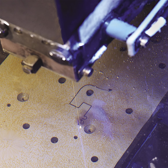

Machining a D-2 tool steel mold lock on a Makino DUO43 using 0.010 " brass wire.

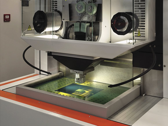

GF AgieCharmilles' CUT 1000 can cut with wire as small as 0.0008 " in diameter. The machine is often used for cutting micro parts and features.
