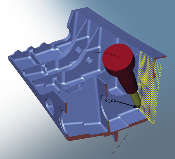

A segment of a structural part is cut with a conical barrel cutter using hyperMILL’s tangent-plane-machining strategy. The conical barrel cutter's 500mm (19.68") radius is significantly larger than an equivalent ball endmill, as defined by the cutter shank size.

The combination of the new CAM programming strategies and special barrel cutters provides technical benefits. The cone angle on a barrel cutter allows the cutter axis, toolholder and machine spindle to be tilted away from the part surface. Accordingly, applying short barrel cutters can lower cutter costs, enable faster machining parameters and impart finer surface finishes compared to longer ballnose endmills. With proper collision detection and avoidance in the CAM software, the holder, and even the spindle, can confidently enter deep part pockets.

Open Mind’s hyperMILL machining strategies—tangent plane machining for planar surfaces and tangent machining for ruled or gently arched surfaces—further improve barrel cutters. Surface selections are simple; approach and retract macros effectively control the large radius in corners; additional passes can be taken with the ball end on the bottom of the cutter to clean up and blend fillets and adjoining surfaces; and obstacles can be identified and easily avoided.
The strategies are suitable for 5-axis, simultaneous motion and 3+2 automatic indexing. Some large machines do not readily allow simultaneous motion because of their need to move large machine masses. Automatic indexing, however, produces acceptable surfaces with imperceptible blends.
