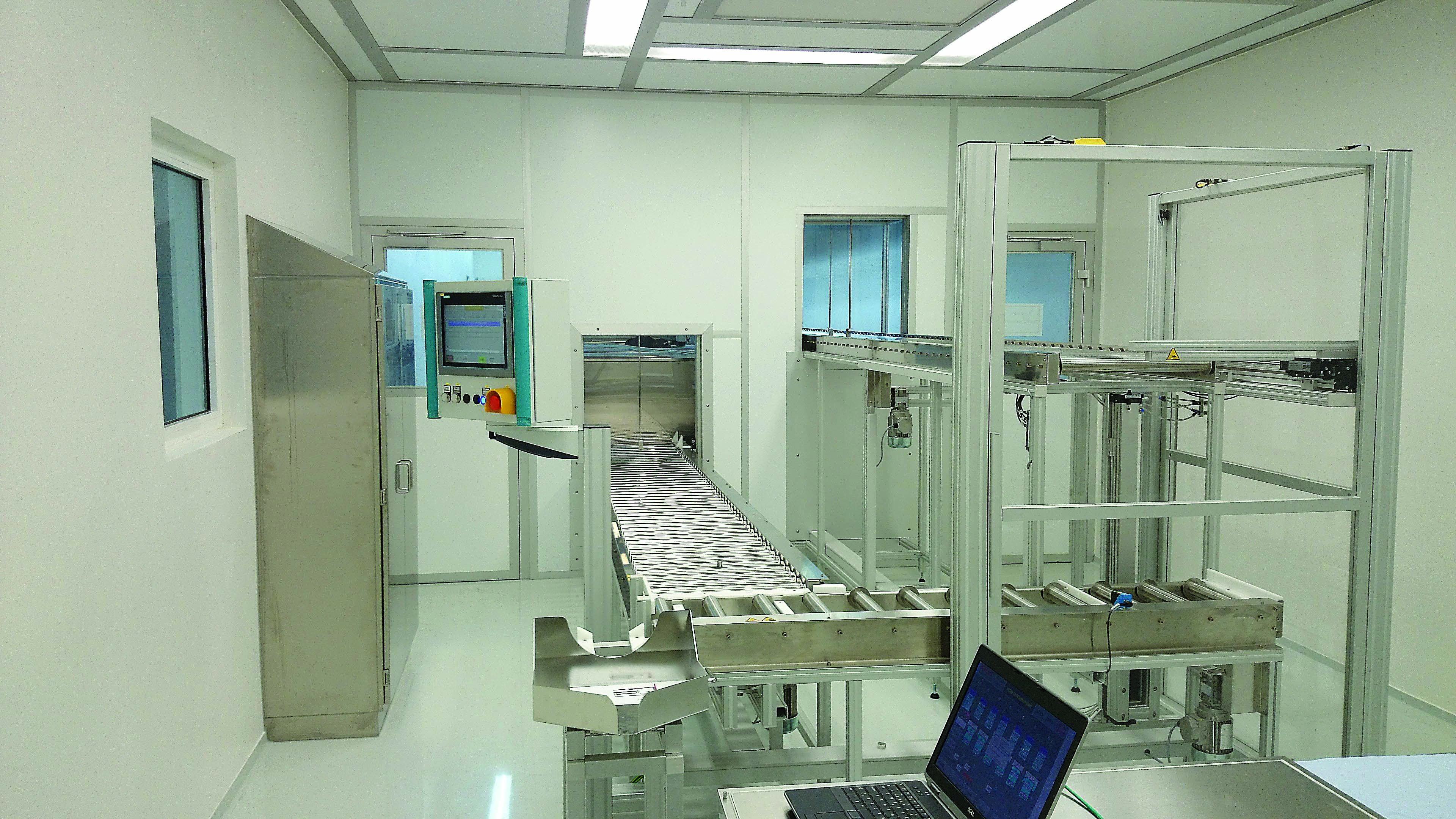

Cleaned parts are discharged into the clean room via a material air lock. Photo credit: Ecoclean GmbH/UCM AG
Cleaned parts are discharged into the clean room via a material air lock after passing through a fully enclosed cleaning line equipped with its own supply of purified air. Image courtesy of Ecoclean GmbH/UCM AG

For highly automated production lines, a more compact, practical alternative to the clean room may be the “clean machine concept,” in which the requisite decontamination technology is confined to the actual production line itself. In parts cleaning applications, this solution is used in multistage immersion cleaning systems, where cleaning baths are fully enclosed and equipped with their own supply of purified air. The cleaned parts frequently are discharged into a clean room via a material air lock.
