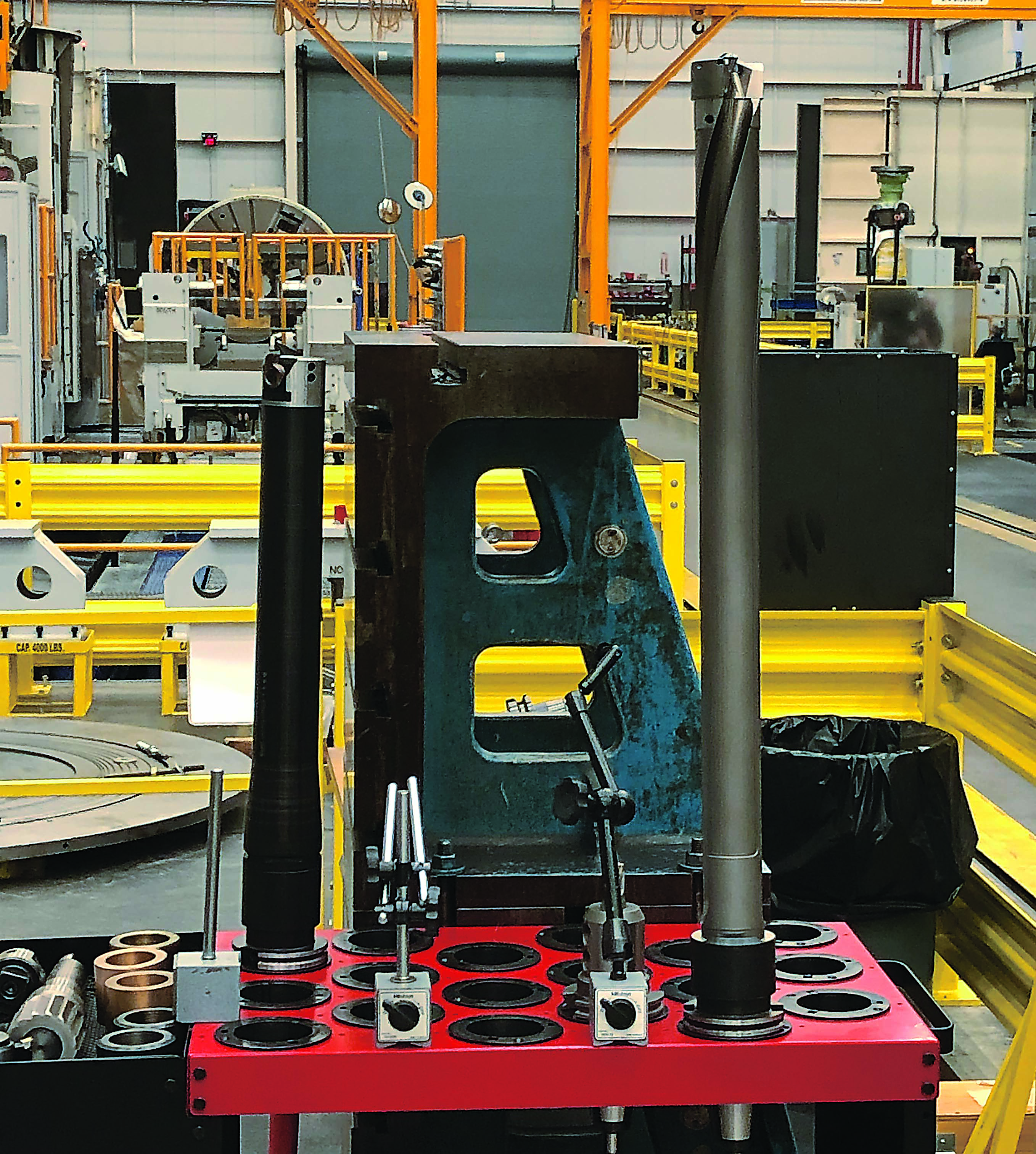

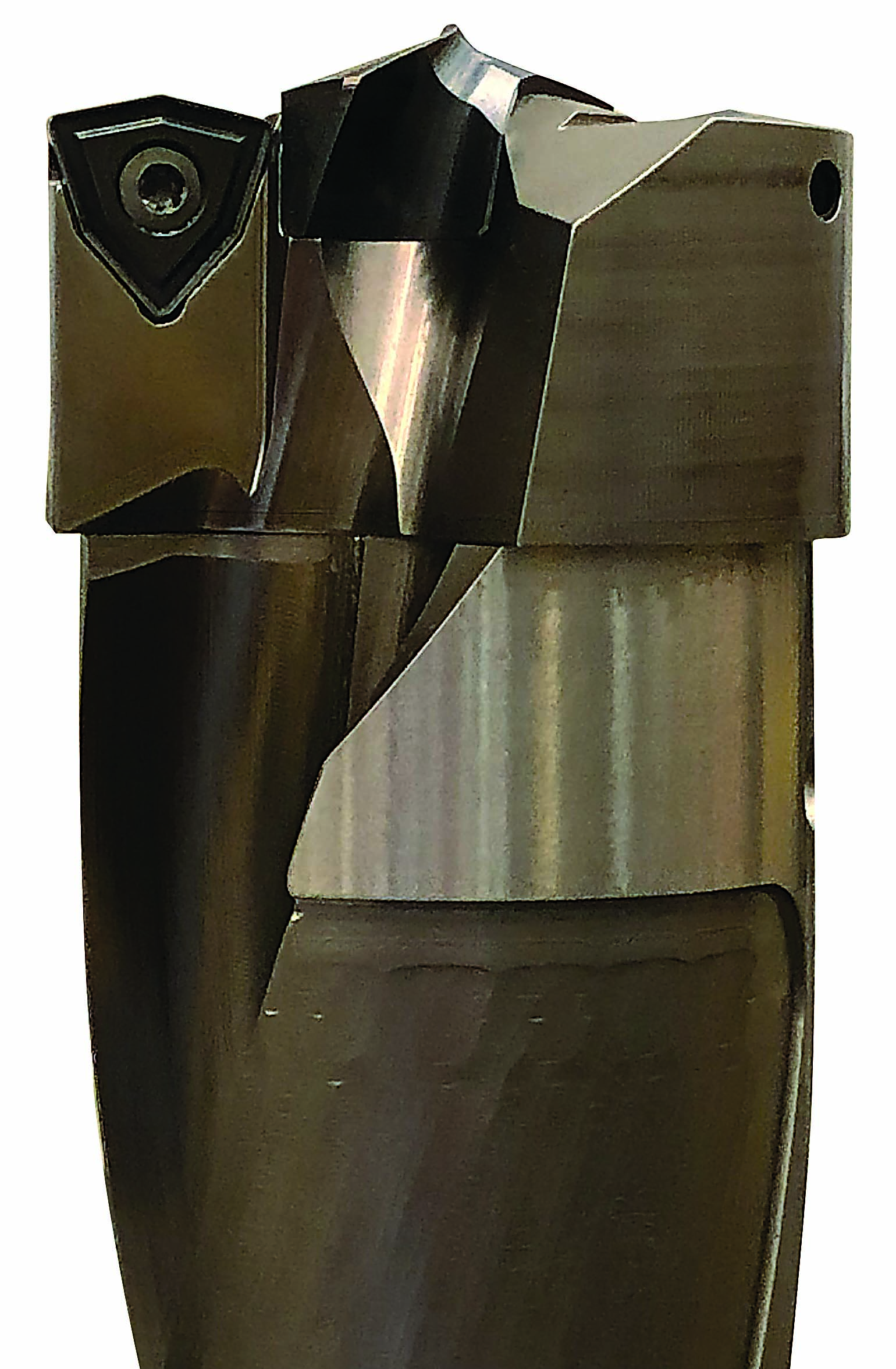

This is one of the largest drills at Mitsubishi Hitachi Power Systems Americas. The drill uses three inserts, and about 10 minutes is needed to change all three. A special piece of grinding equipment and several hours would be required to sharpen an HSS drill this large. Images courtesy of Christopher Tate

Inserts and indexable tools have a distinct cost advantage over other types of cutting tools. Drills and endmills are a good example. Typically, tools that are larger than 1" in diameter are expensive. Production-oriented shops might need several large HSS drills to ensure that production does not stop when tools become dull, because sharpening is done outside the machine tool and often sent off-site. But change the HSS drill for an indexable-insert drill, and now a shop may need only one tool. When it is dull, a user simply rotates or replaces the insert without removing the tool from the machine and frequently without resetting the machine. The result is less downtime, reduced cost of tool ownership and fewer opportunities for mistakes when resetting the tool. For very large tools, such as the 80mm-dia. × 600mm-long drills we use at Savannah (Georgia) Machinery Works, indexable tools are the only thing available because it does not make economic sense to buy such a large HSS drill.
