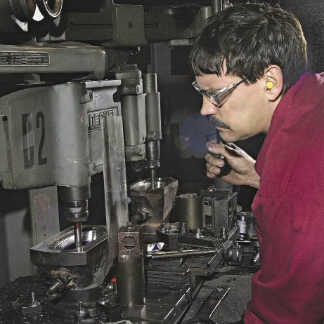

Keith Hoover, a machine operator at Quality Mould, operates a Deckel pantograph milling machine to remachine an aircraft lighting lens mold in the foreground, matching it to the one the machine is tracing in the background.

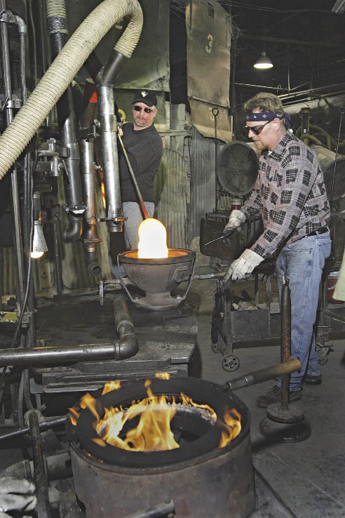

At Chromaglass, a glass products manufacturer, presser Art Theys (foreground) and gatherer Ernie Ryan use the mold machined by Quality Mould to make the lens.

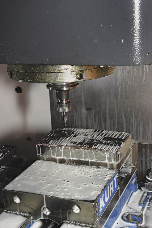

The shop recently purchased two machines to cut larger workpieces, a Mazak VTC 300 vertical machining center with X-, Y- and Z-axis travels of 65 ", 30 " and 26 ", respectively, and a Doosan Puma VT900 vertical turning center for parts up to 40 " in diameter. Many mold components, such as those for lighting applications, are round and involve turning. “Then, if it gets holes or slots, it will go into the mill,” Danko said.

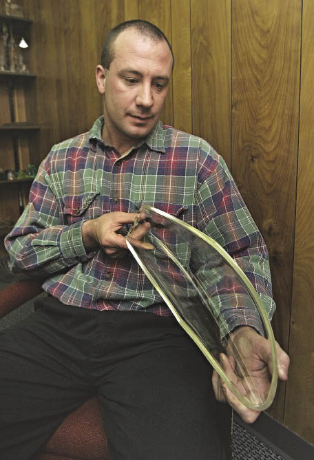

D.J. Danko examines a glass lens for an aircraft landing light that was formed in a pressed-glass mold designed and manufactured at Quality Mould.

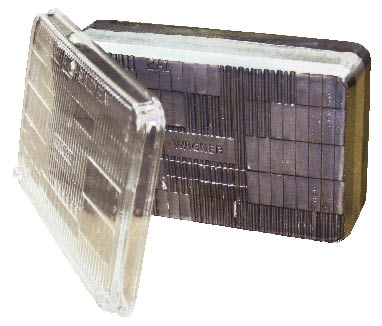

This detailed plunger, being milled from Inconel at Quality Mould, is used to press a replacement automotive headlight lens like the one shown.
