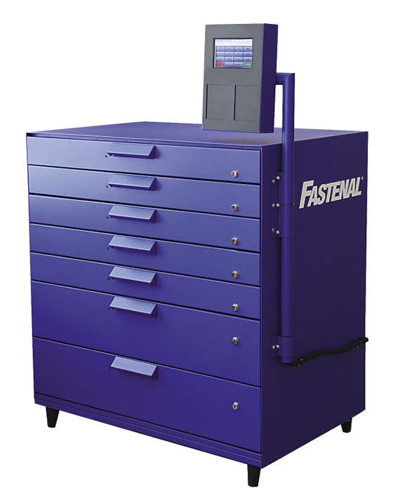

Fastenal has added a drawer unit to its FAST 10000SL series. The seven drawers have 168 total bins equipped with weight-based sensing technology.

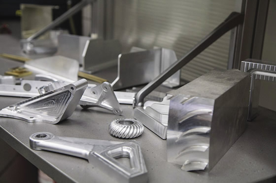

A pool of about 2,000 different, complete tools is available for machining the parts, which have prismatic and free-form surfaces. Lufthansa Technik programs the elaborate NC programs for the parts’ complex geometries with Edgecam CAM software and uses the >>venturion 450<< CNC tool setting and measuring machine from Zoller. Lufthansa selected the Zoller machine after conducting a cost/benefit analysis, according to the company’s Planning Engineer Frank Pieterwas. “Decisive for us was the expandability and linking to the machine tools.”

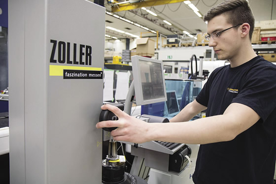

Lufthansa Technik uses a Zoller >>venturion 450<< tool presetting and measuring machine (top photo) in connection with producing an array of components (below).
In addition to the potential of introducing a tool database that’s superimposed on the company’s machining system, application details favored the Zoller unit when Lufthansa compared machines from different vendors, said Jan Horn, CAM specialist at Lufthansa. “The graphic user interface for the otherwise laborious presetting of fine drilling tools, for example, or the fact that I can clearly view the cutting edge with the magnifying glass [are key advantages of the Zoller machine].”

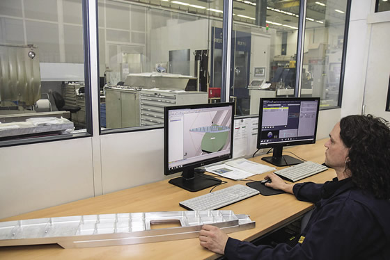

However, the distribution of data from Edgecam to the Zoller system to the machine control resulted in redundant data management. This led to increased inefficiencies and contained potential error sources because of the need to manually reenter data.
As a result, Lufthansa added the Zoller TMS Tool Management Solutions system. “If a new tool is set up, it should be entered into the Zoller tool management database, so the name is correct, as well as the description and the magazine place number,” Horn said. “Thus, once entered, it can be consistently found and used by all employees in a standardized manner throughout the entire manufacturing process.”
With the interface from Edgecam to TMS already established, Lufthansa linked the tool memory of the CNC machines and the Zoller presetting and measuring machine via the Zoller database. This ensured data consistency from the CAM system to the machine tool. All data is saved in TMS and accessed by the CAM system. The measuring requirements are saved in the database directly next to the tool and are available on the measuring machine. Measurements are made at the push of a button and the tool data is transferred to a machine tool to ensure consistency and eliminate manual-entry errors and redundant tool data.
The tool data is available in the CAM system as a 3D model. The system then programs using real data and outputs the data of tools on which machining simulation was performed. These tools can be assembled on the machine in the same way they were simulated.
After the first 6 months of operation with the tool management system, errors were significantly reduced. “Everyone downloads their NC programs into the machine; the tools are included and have standardized descriptions,” Horn explained. “I use a single set of tool data. Once I have written a program in Edgecam, it applies to all machines. All I do is change the post-processor, send the NC program and the process is completed.”
