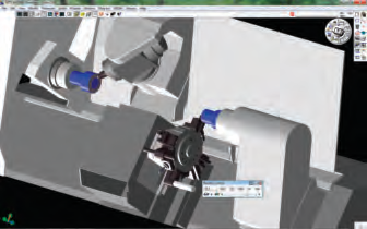

According to Bill Gibbs, president of Gibbs and Associates, Moorpark, Calif., CAM software for programming MTMs highlights a basic difference among various CAM software developers. “There are two basic philosophies in NC programming,” Gibbs said. “One is, make decisions for the user and strive to be maximally automatic. We strongly believe that the goal of maximum automation is illusory because, if everyone programs a part the same way, what value does a shop offer? They’re just commodity brokers of machine time.”
Gibbs said software should be a “power tool” for the machinist. “We want to enable his methodologies, his tooling, his cuts,” he said. “So we make it very simple for programmers to move tools around, move operations from one turret to another and other tasks. As he interacts with the software, it’s telling him what overall run times and the cycle times of individual operations are going to be.”

The multispindle, multiturret, multiaxis simultaneous machining capabilities of MTMs make programming without the right tools a challenge.
