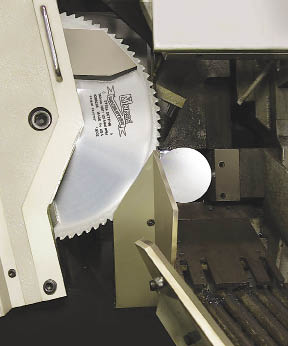

Courtesy of M.K. Morse
M.K. Morse’s Revolution cermet-tipped saw cuts a solid steel bar.

Similar to how nickel bonds to a diamond wheel when grinding cermet, cermet has an affinity for nickel in workpiece materials. That causes nickel to bond to cermet teeth, causing tooth galling and reducing tool life when sawing stainless steel and nickel-base superalloys. “When cutting stainless, we recommend using a carbide-tipped blade rather than a cermet-tipped blade,” said Tsune’s Overstreet.
According to M.K. Morse’s Wanigarathne, however, cermet material advances have made sawing stainless with cermet more appropriate. Those advances include reducing the material’s grain size, improving the saw blade manufacturing process and changing the material’s properties by adding tantalum, molybdenum and other alloying elements. “People thought at the beginning that machining stainless steel was not a suitable application for cermet, but now you can do it,” he said.
On the other hand, a cermet saw is highly suitable for cutting low-carbon steel. “The customer will see optimal cutting life when sawing carbon and alloy steels with less than 0.40 percent carbon content,” Tru-Cut Saw’s Otter said.
A cermet saw lasts about twice as long as a carbide one for those applications, according to Tsune’s Riebl. “If somebody cuts 1018 steel, we say use a cermet blade.” However, he noted that carbide is a better choice when there’s interrupted cuts, such as when sawing tubing.

Regardless of the type of workpiece material, it needs to be firmly clamped when sawing to eliminate vibration and avoid chipping the cermet. For example, Pro-Mark Sales’ Holland indicated that the Amada CM-100 circular sawing machine the company uses for its cermet saw cutoff services clamps the workpiece from both sides and has a vertical clamp that comes down from the top onto the material being cut. In addition, the machine provides a large guide for both sides of a blade.
“When you have a thin-kerf blade, you must have a nice guide system so there’s no flexing in that blade whatsoever,” Holland said. That helps ensure a high level of squareness in the cut.
