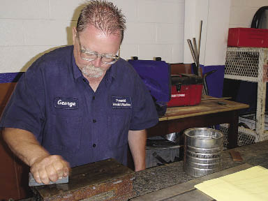

Maintaining the magnet is a must for surface grinders. About every 6 months, depending on usage, remove the magnet and clean it and the table beneath it. After removing all the grime and scale, stone the bottom of the magnet and then lightly oil that surface and the table before reinstalling the magnet. Apply a light film of the machine’s way oil, which won’t contaminate the grinder’s coolant.
Stoning a surface grinder magnet is an effective way to remove the final bits of corrosion and to flatten it before reinstalling it on the grinder.
Lack of magnet maintenance will produce a scale and corrosion buildup between the bottom of the magnet and the table. If left unchecked, this scale can accumulate to a thickness of about 1⁄16 " and distort the surface grinder table to the extent that it no longer rides true in the ways. If scale buildup is permitted to remain, the way surfaces of the bed and table wear because of point loading caused by the table distortion. If this occurs, then the only remedy is to rescrape the ways to restore the grinder’s accuracy, a process that can sideline the grinder for 2 or 3 weeks. The amount of time depends on the complexity of the grinder and degree of wear. One week may be sufficient for a small surface grinder with minimal wear, whereas it may take a week to dismantle a large rotary grinder prior to beginning the realignment work.
